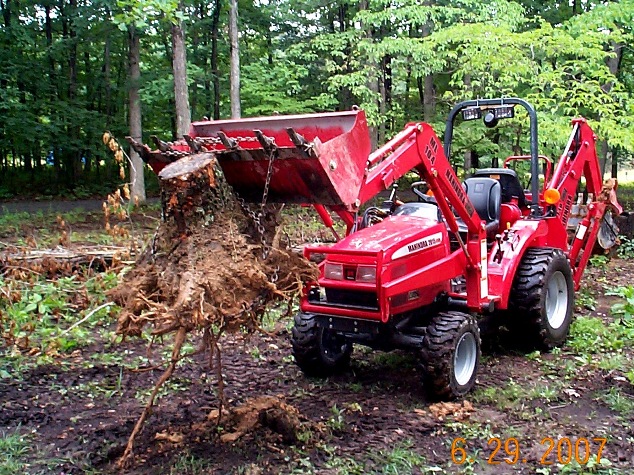

So far, it looks to me like the Mahindra's are the widest, though the JD 3000 series with ag tires set wide could win. They are a bit tall though. The 26hp+ Mahindra's are around 60". Though the 20hp Mahindra is not that wide, it has a very solid stance, and feels stable when operaing, partly because it is heavy for it's size.
