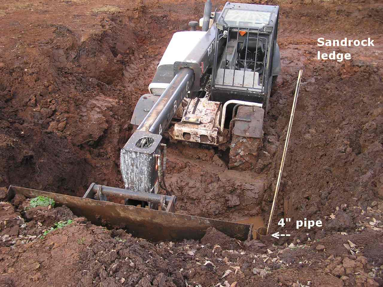

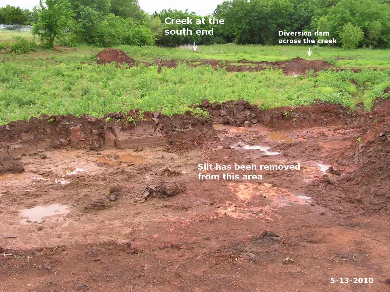

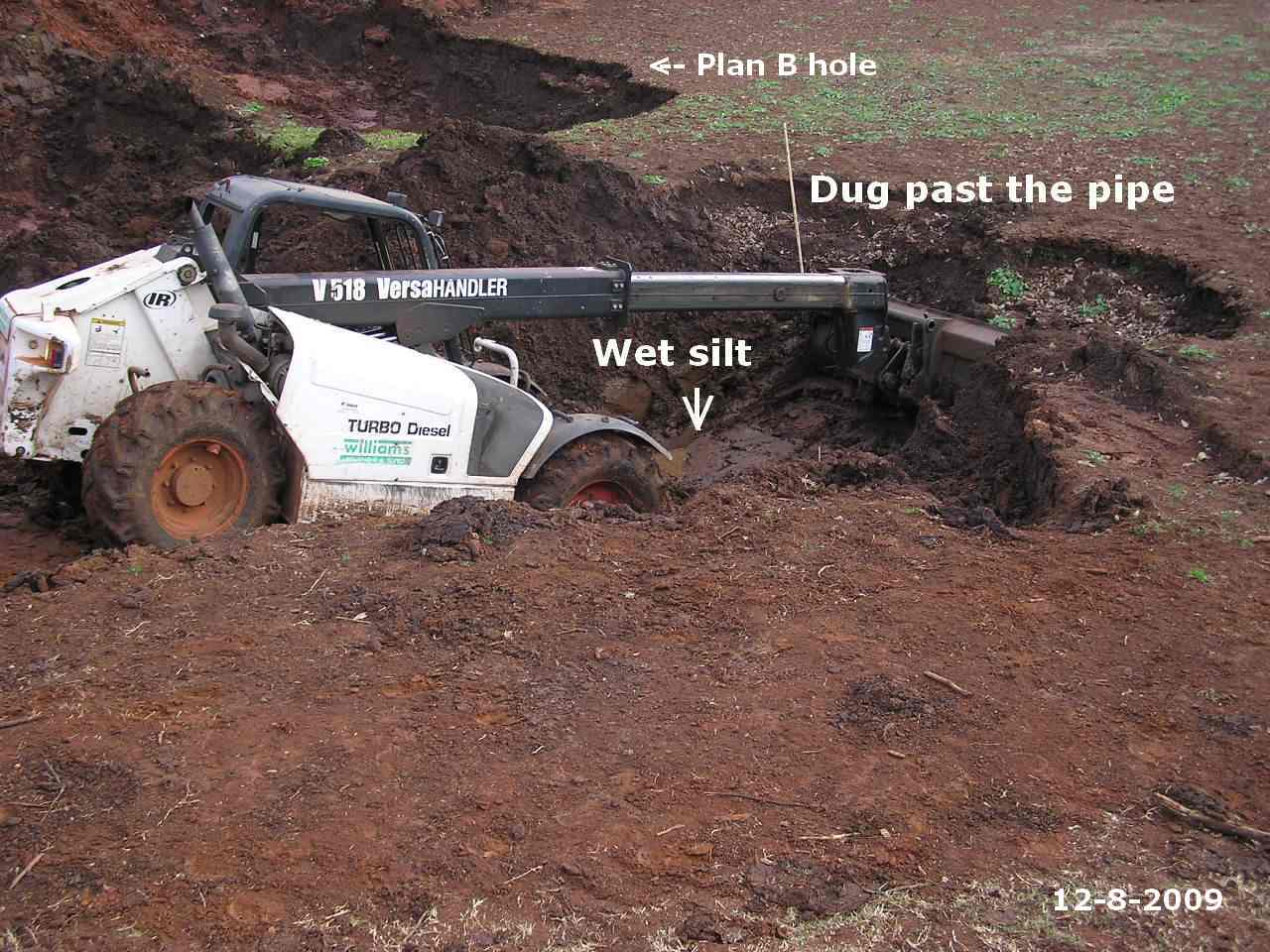

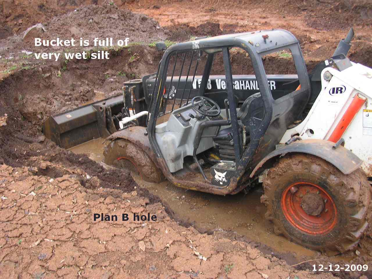

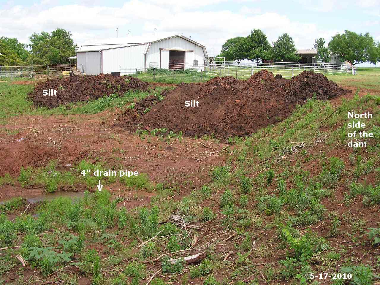

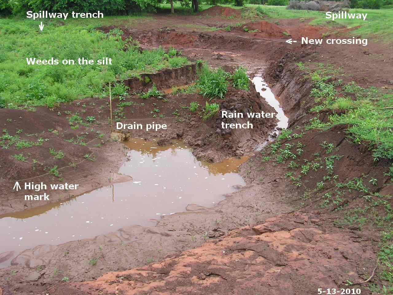

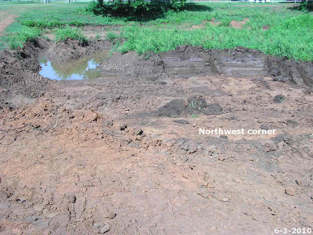

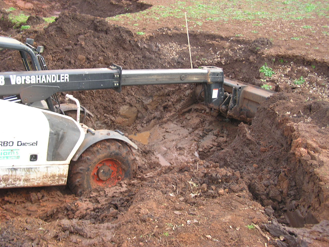

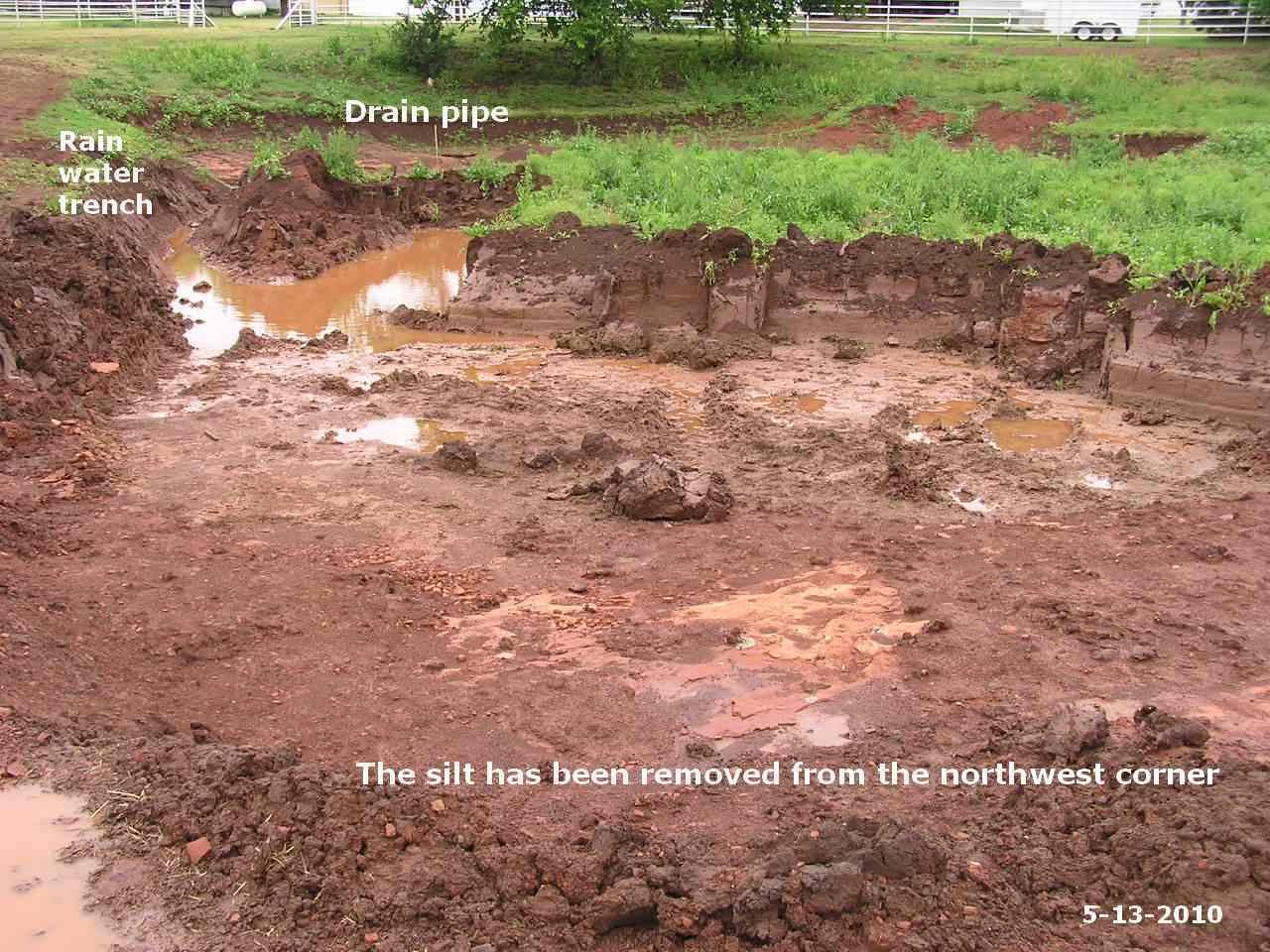

A mate of mine, with far more tractor experience & expertise than I, has switched/mounted his front tyres only on his largest tractor (McCormick) so that the tread points backwards... he said it gave better grip/braking when descending. His tyres are loaded too. This is for haying on very steep paddocks, and the rear tyres have also been extended from the axle using a factory kit.
I turned the front tires around on the V518 to get more grip when backing uphill during my silt removal project.
It made a noticeable difference. :thumbsup:

What were u doing, digging out a pond ? Looks like a messy job
