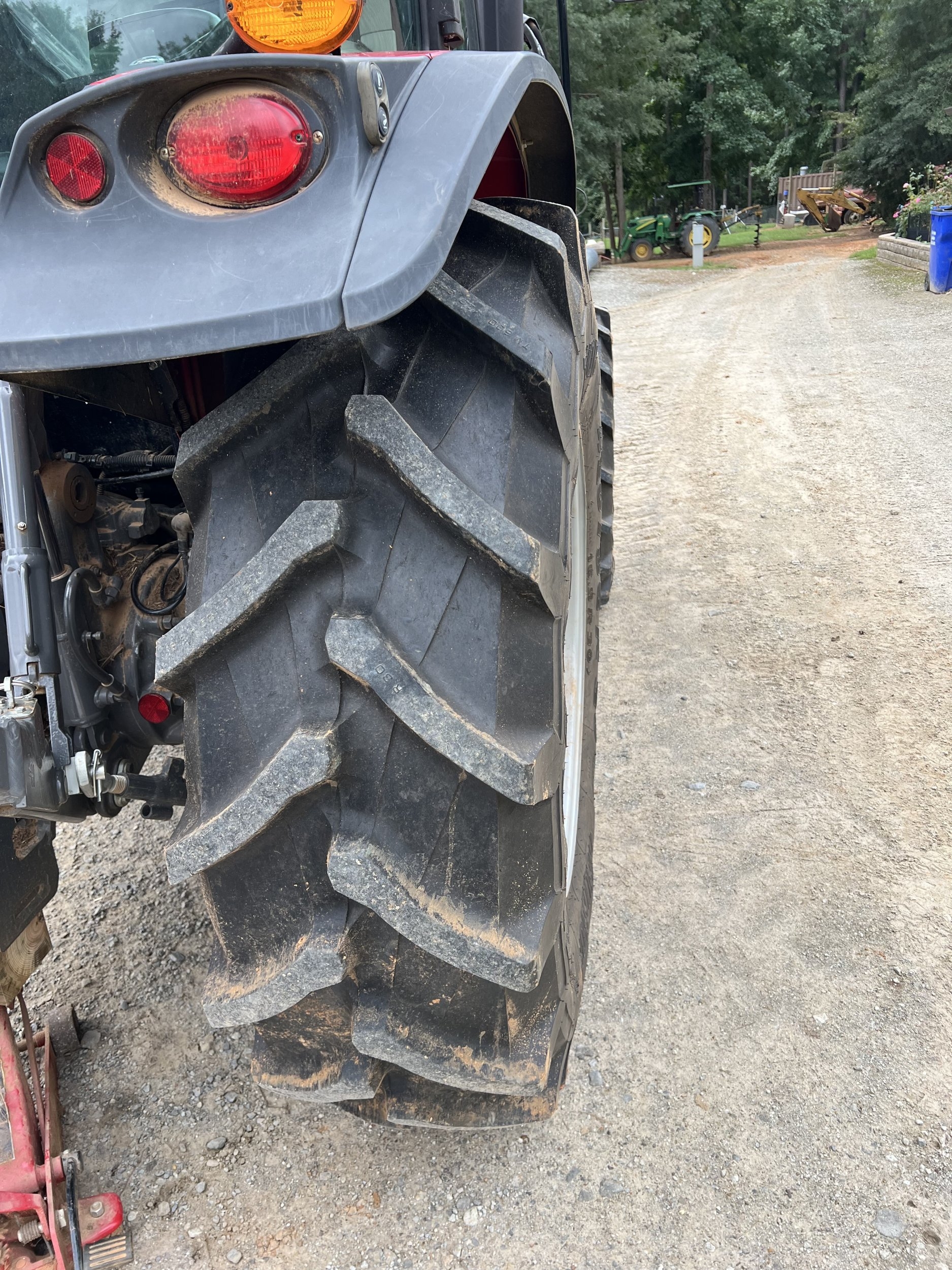

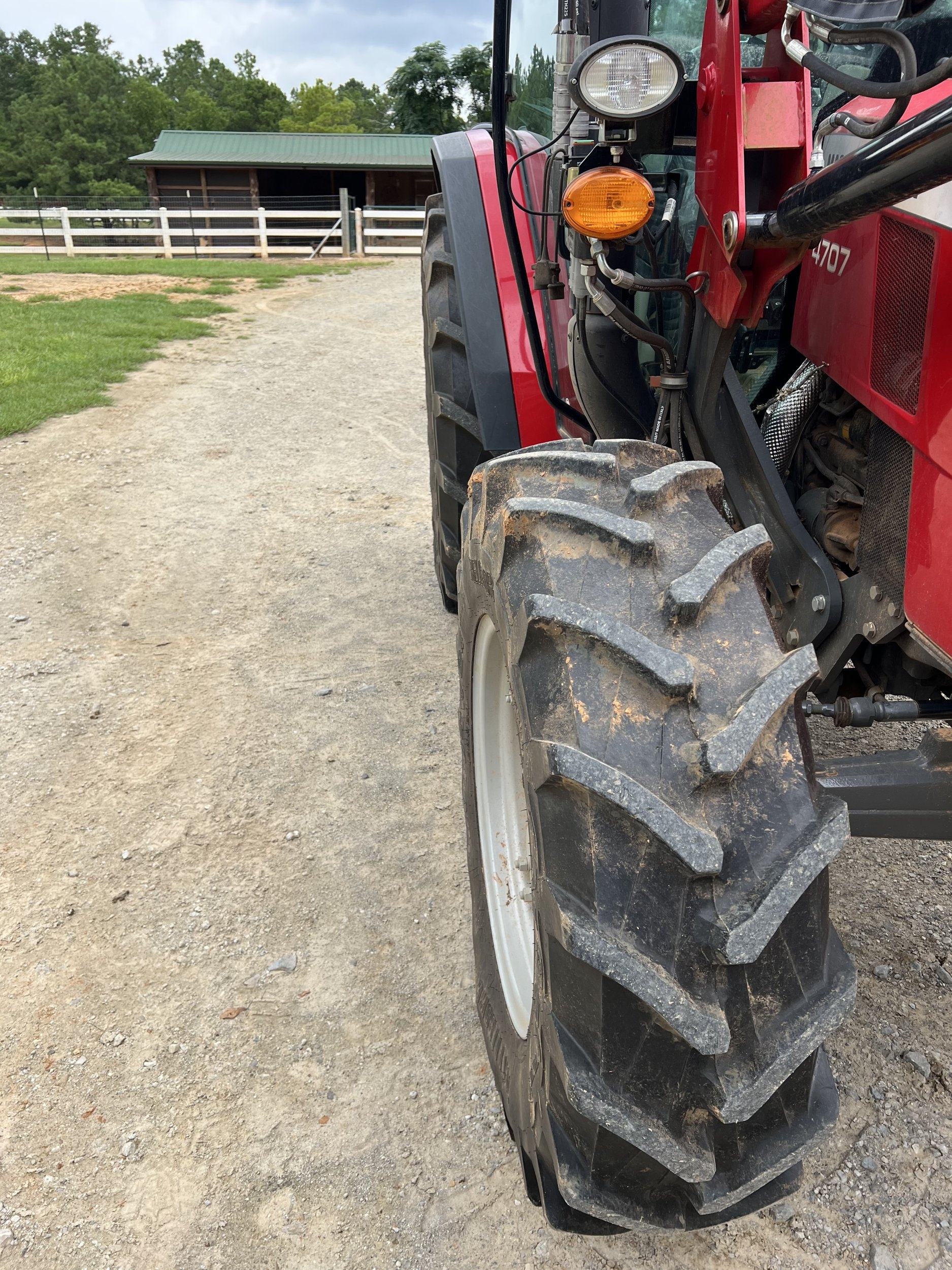

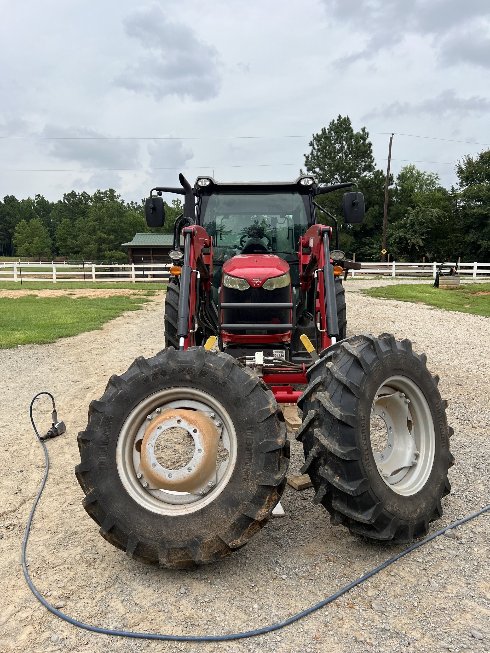

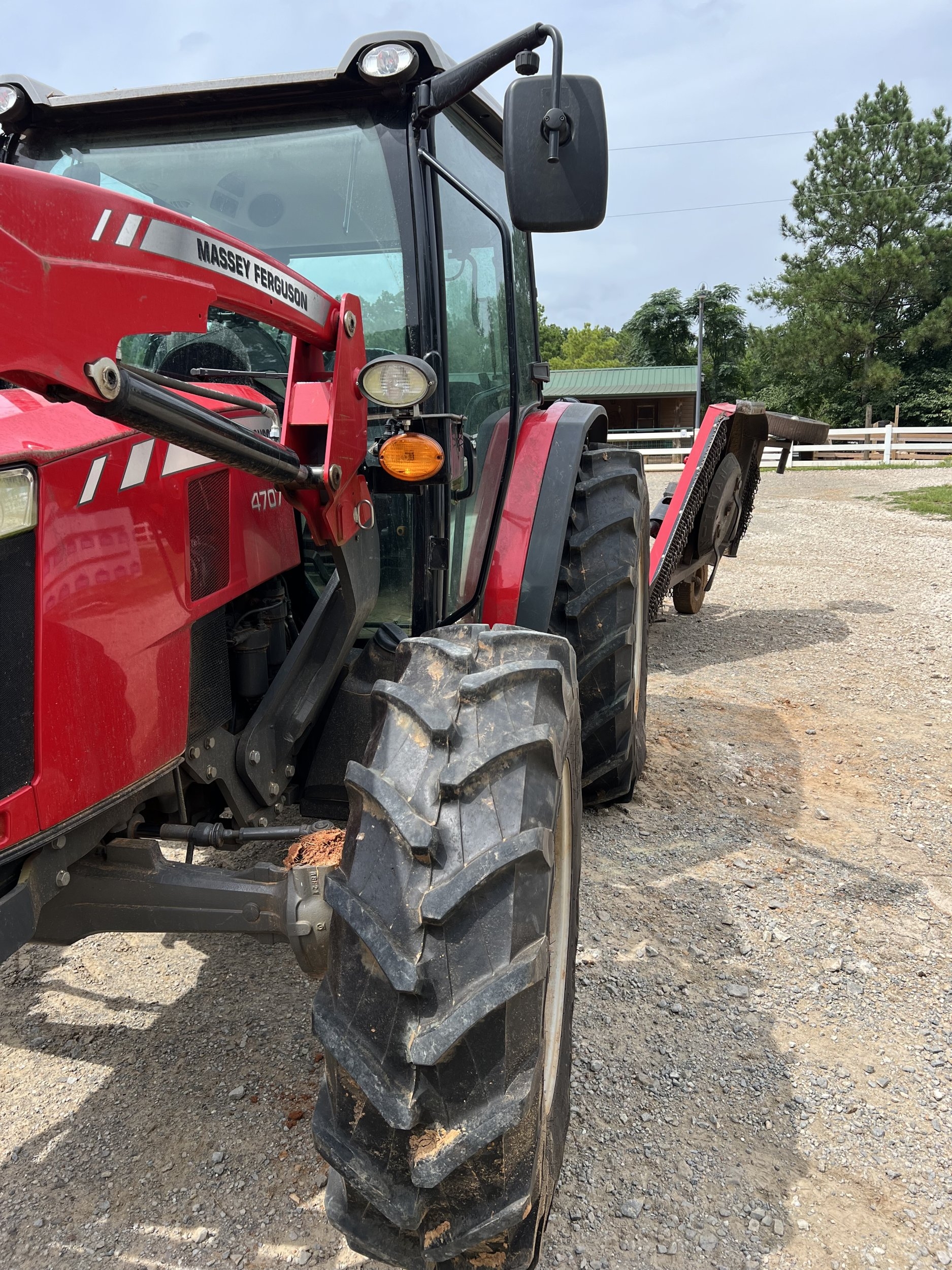

My 4707 Massey Ferguson feels kind of tippy when I'm mowing around my pond. I've been mowing it for two years now with that tractor, and it still makes me nervous. Before that I mowed with a smaller, open station tractor, and a 6 foot cutter, and that made me nervous too, but not as bad as the Massey. I think it's because it's so much taller.
Yesterday I decided it was the day to widen my tires. The rims are two piece, and according to a YouTube Video from a Massey Dealer, there are four ways to mount your tires that change there width. From what I could tell, they came from the dealer as narrow as they can be. I measured them at 82 inches wide, to the outside of the tires.
The before pictures. Notice how the tires barely come out past the fenders.
The tires are freakishly heavy. Once I got them off, I removed the inner rim and flipped it over. Then I swapped the tires from side to side. Before I did this, the valve stem was on the inside, and very hard to get to. Now it's on the outside, and probably easier to damage while mowing, but it's now easier to get to.
Left tire has the inner rim switched to the wider position. Right tire is still in the original position.

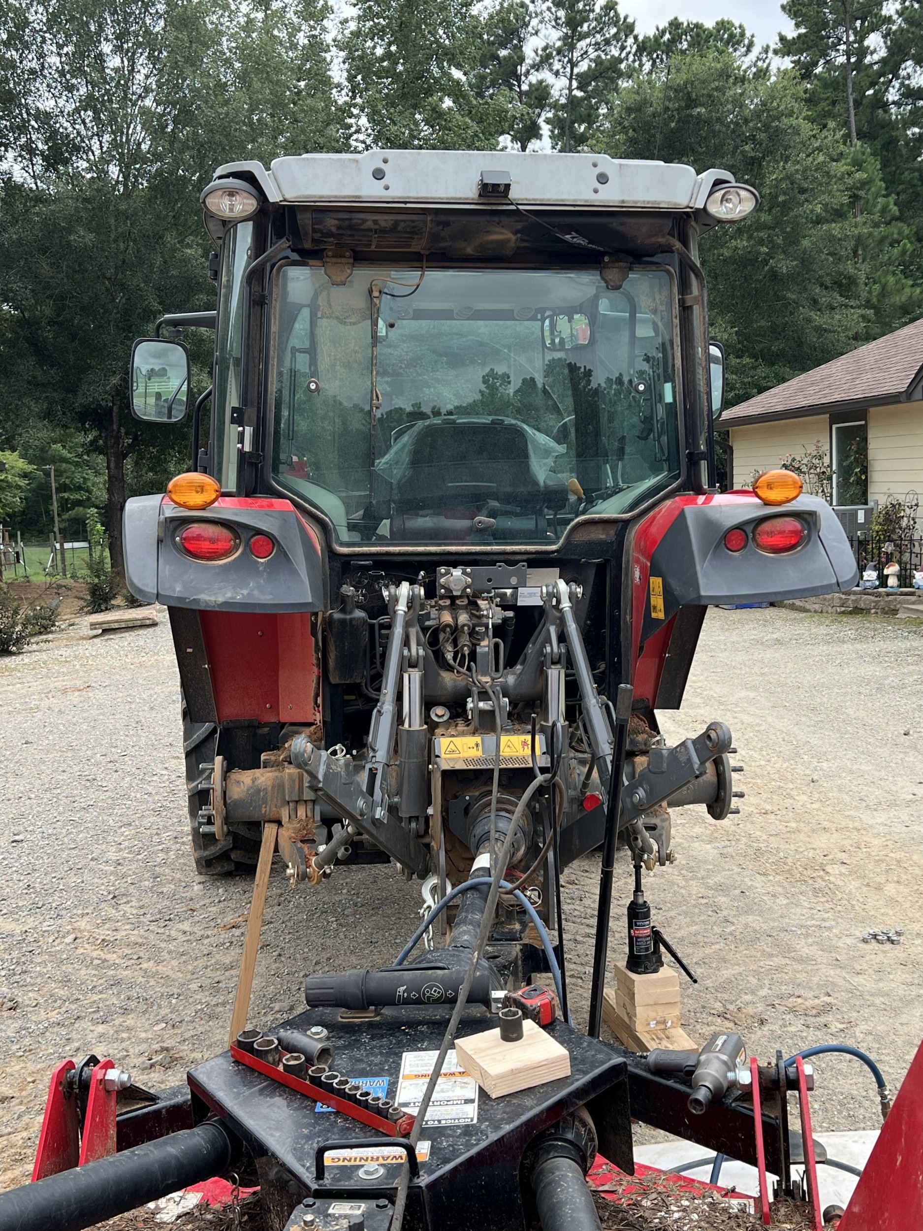

I barely jacked the tractor up high enough to get the tires off the ground, then I slid them off the axles. Getting them back on was more challenging because of how heavy they are, and how awkward it was to line it all up.
Now the wheels measure 93 inches to the outside. I gained 11 inches of width!!!! The rear wheels stick out past the fenders quite a bit more now.

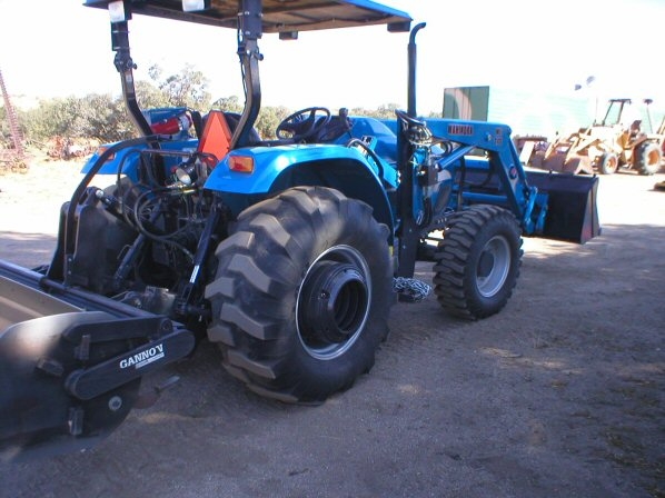

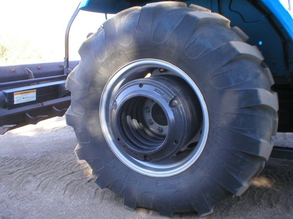

I know on my 75hp machine, I used it for 1 year to get a real feal for the machine.
I then added 3 sets of cast wheel weights. That did not get me the feel or the added capacity that I was looking for.
I then filled all four tires, holly sxxt!!! It was like using the next larger frame size machine and it felt (to me anyway) like it was glued to the ground. Areas on my property that were "iffy"before, became completely comfortable to operate on.
I know that adding the weight to the front tires does nothing for stability, but it helps for added traction. As it was I added even more cast weights now having a total of 6 sets of weights helping my tractor to reach its maximum capabilities.

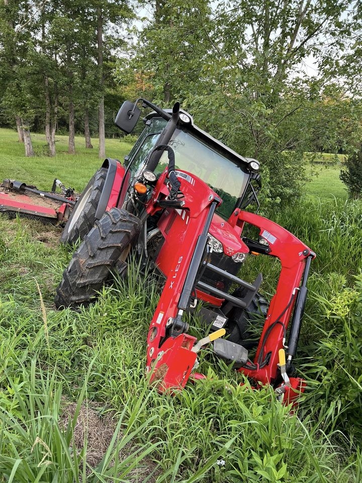

So glad to see you did this, that picture of the machine on the pond slope had me holding my breath! I bet you will notice an immediate difference.
