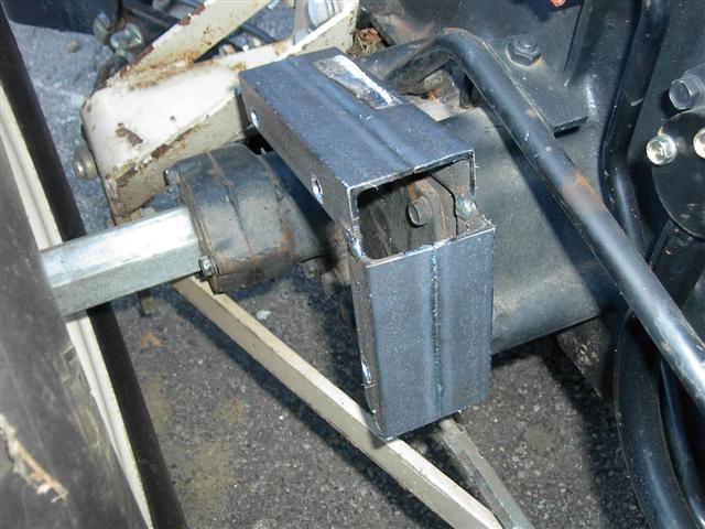

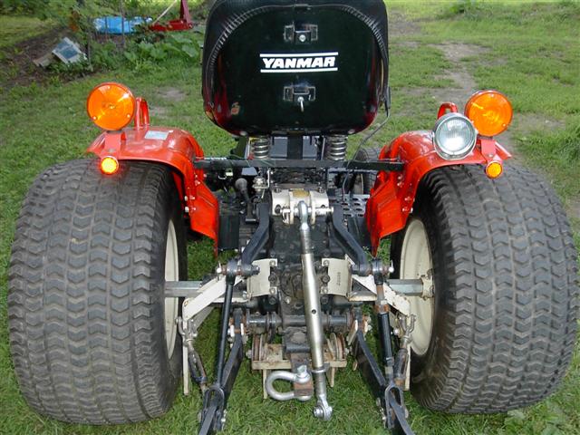

I've been thinking about this for months, and finally yesterday i decided to start in on this little project. I run my rear wheels at one of the widest settings...... mostly to clear the bracketry for my Woods belly mower. Since that leaves my tires mostly uncovered by my fenders, i thought i'd remedy that. Also..... the operators station could always use a little more space.

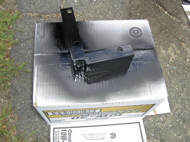

I had a few pieces of inch and a quater angle from another project, so i decided this is what i would use for brackets to space out the fenders. In retrospect..... channel would have been much easier, but i had none hanging around. This will end up making my fenders 5 inches wider.

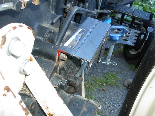

I'm still in the mock-up stage, but one spacer is partially done. Simple enough, with holes on either side ....... to bolt where the fender was, and to bolt the fender to it. My fabfication skills are not as good as my imagination, but hopefully..... when all is said and done, and all the pieces painted black, the change should hardly be noticeable.

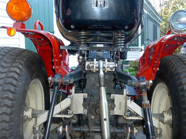

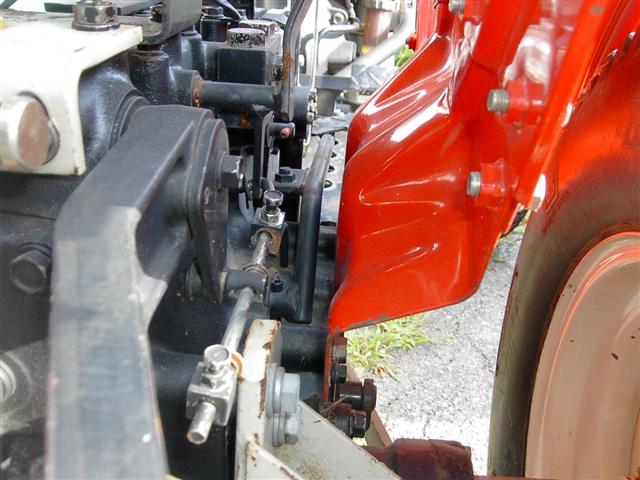

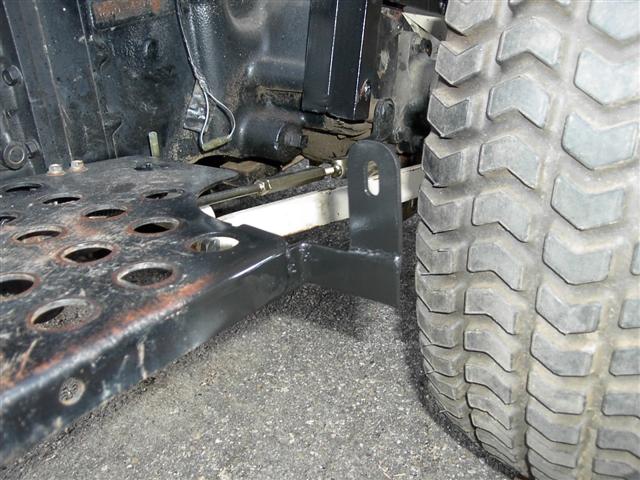

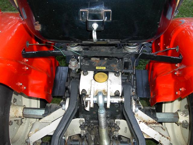

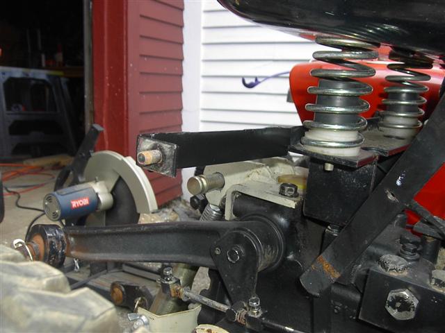

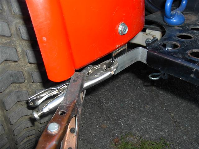

Once the spacer was made..... it was time to widen the bracket between the seat base, and the fender. I cut it and welded in a piece of flat stock to bring the stud out two and a half inches. Then..... i trimmed the tab off of the foot-board which held the bottom/front of the fender. I made a piece to bring this out 2.5 inches also. I hope to have all the cutting and welding done today..... but most likely will not get the peices in primer and paint till later on this week. The wiring for the lights was plenty long enough for this.... it was spiraled around the seat base/fender brace. No lengthening of the wires will be required

Then....after the fenders are in place..... it looks like i will have to make a small filler for the rear of the foot-board, so that there will be no chance of getting a heel caught in the new found space. And..... i will also widen the pedal for the diff lock...... also to ensure i will not get a heel caught between the pedal and the fender.
Here is a pic during mock-up, hopefully showing the right side being wider... in comparison to the left being stock.
I'm sure others have accomplished this. Am i overlooking anything?

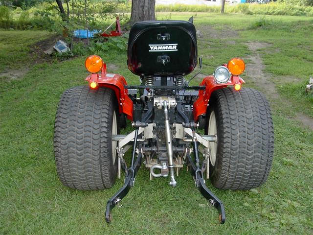

OK..... finished up the left side today. Made a copy of the right side fender spacer...... and ..... it actually fit??? Unusual for my projects !

I know it doesn't look significantly different...... but i took her for a spin after i finished, and the five extra inches between the fenders adds a noticable amount of leg / foot room. I will need to widen the dif lock pedal as i had anticipated. Definitely enough room to catch your shoe between the pedal and the fender now. That could be a problem during an emergency exit. Well worth the sunday afternoon !
