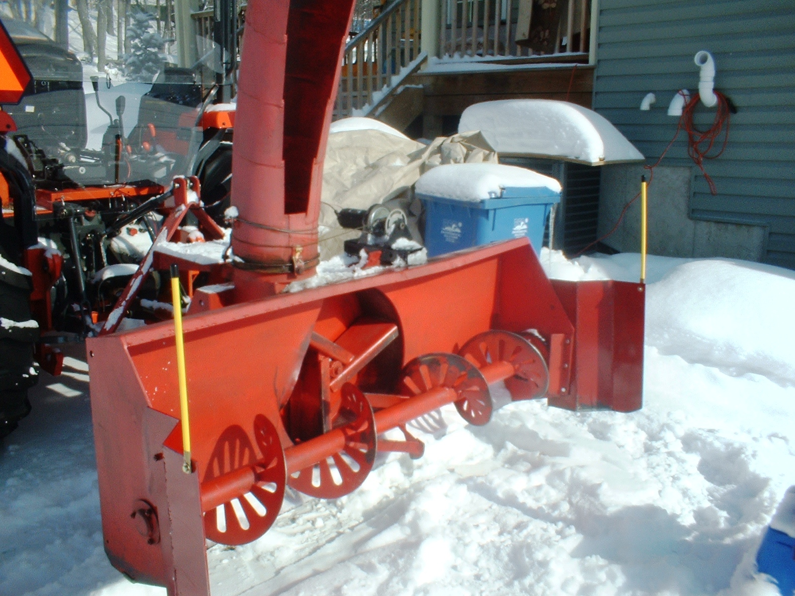

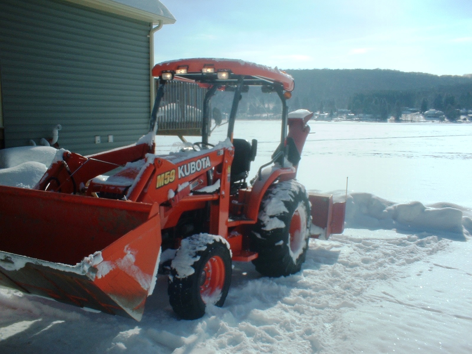

When I had my Kubota L39, my Mackee M520 snowblower measured 72" which was perfect for that tractor's width....when I upsized to my current M59, I found the wheels tracked into the banks when turning....I added wings on the blower extending the width to 81", 41/2" on either side.
It's worked perfectly for my needs and a lot cheaper than replacing total equipment. :thumbsup:

Where did you get the yellow sticks? Nice job.
