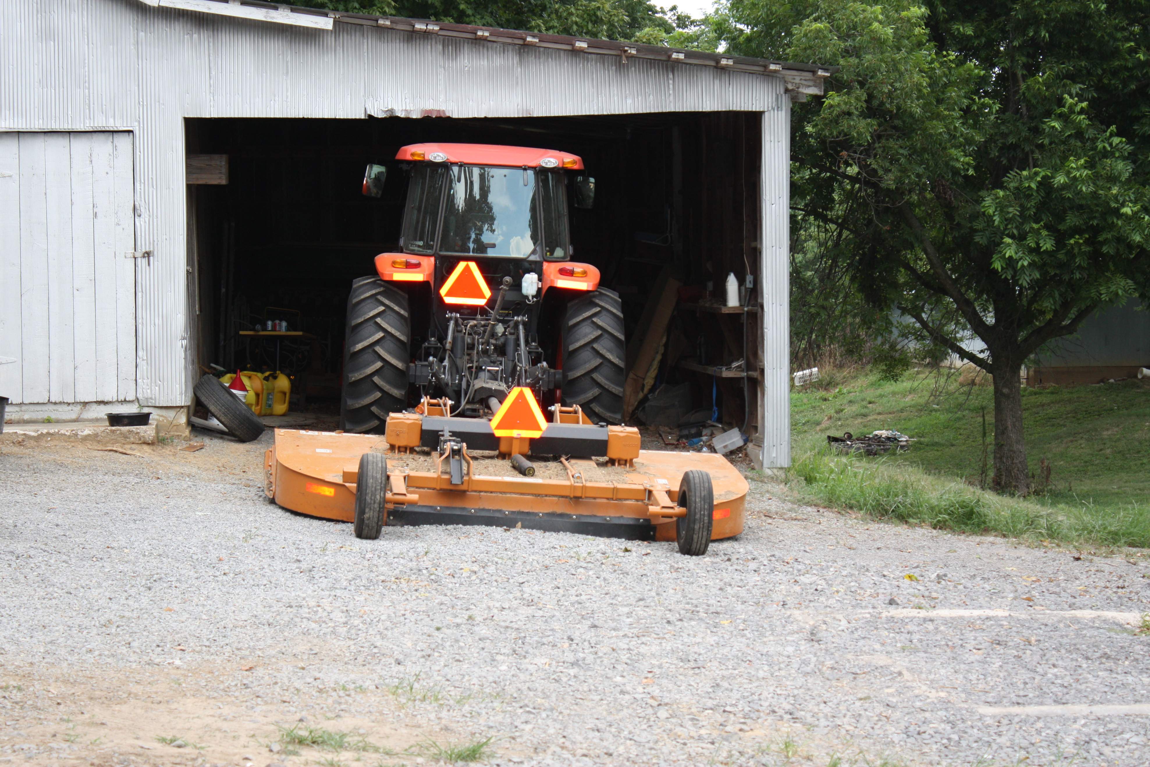

I think my M6040 must be adjusted out about as wide as they will go. The rear tires are 80" - outside to outside. With 15" wide R-1 rear tires that makes it around 65" - center to center. I have no "row crops" to worry about - my rears are filled with rimguard also.

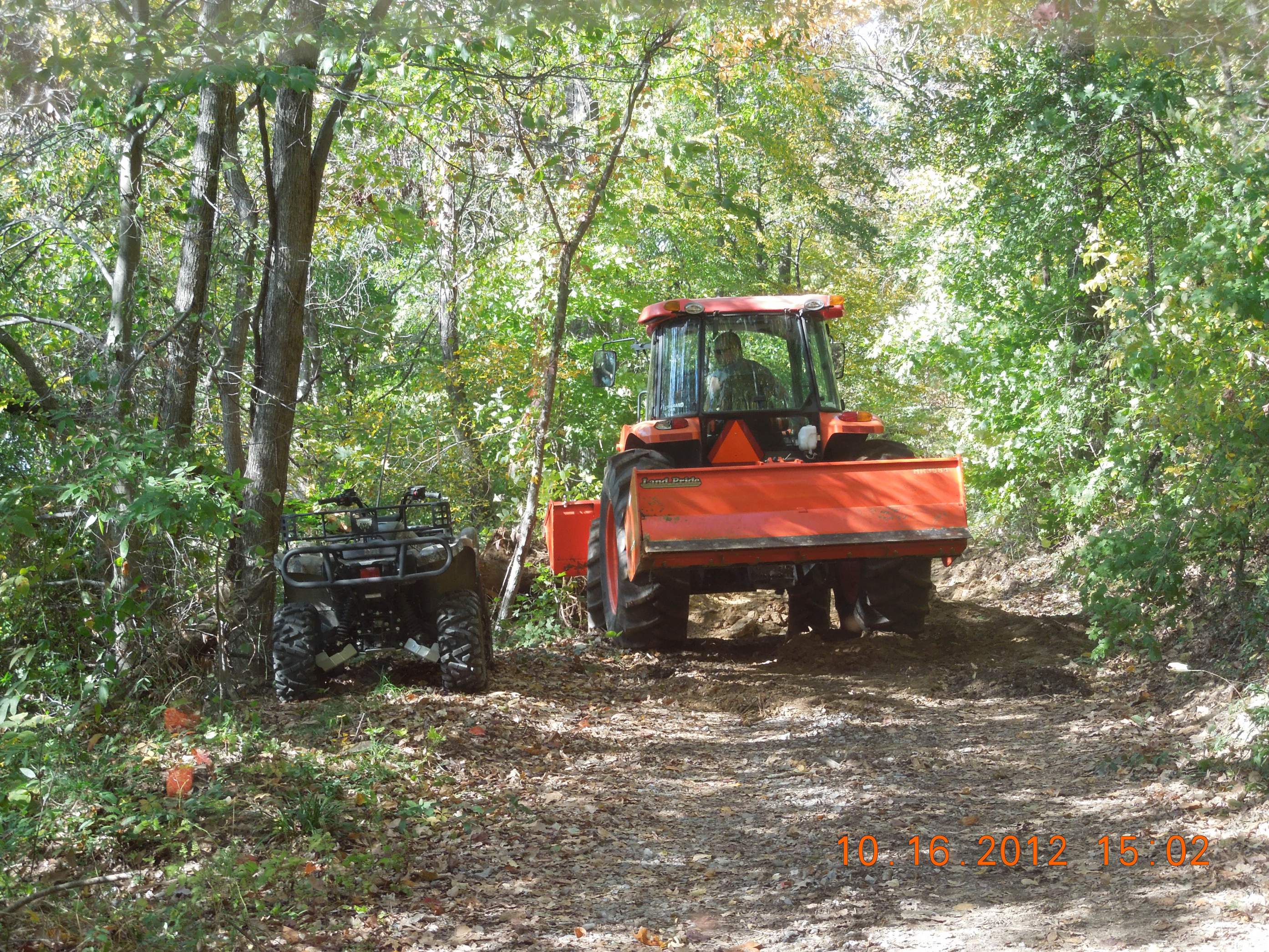

We had ours set at the medium setting, didn't measure inside, but it's about 84" outside as we use an HR3584 box scraper. We run in hills and pull a 10 rotary cutter; thought we might have to go wider, but it's proven really stable.
