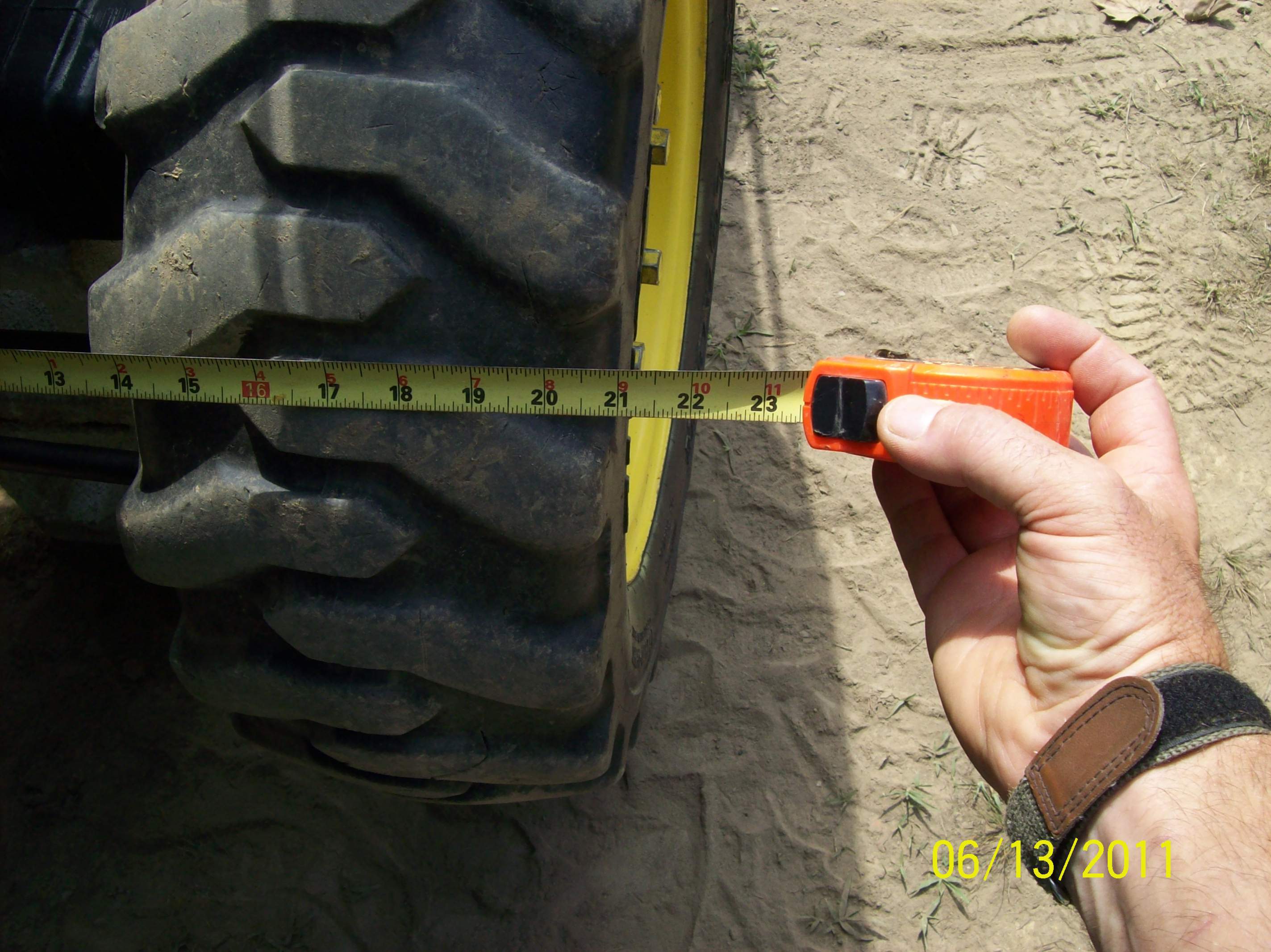

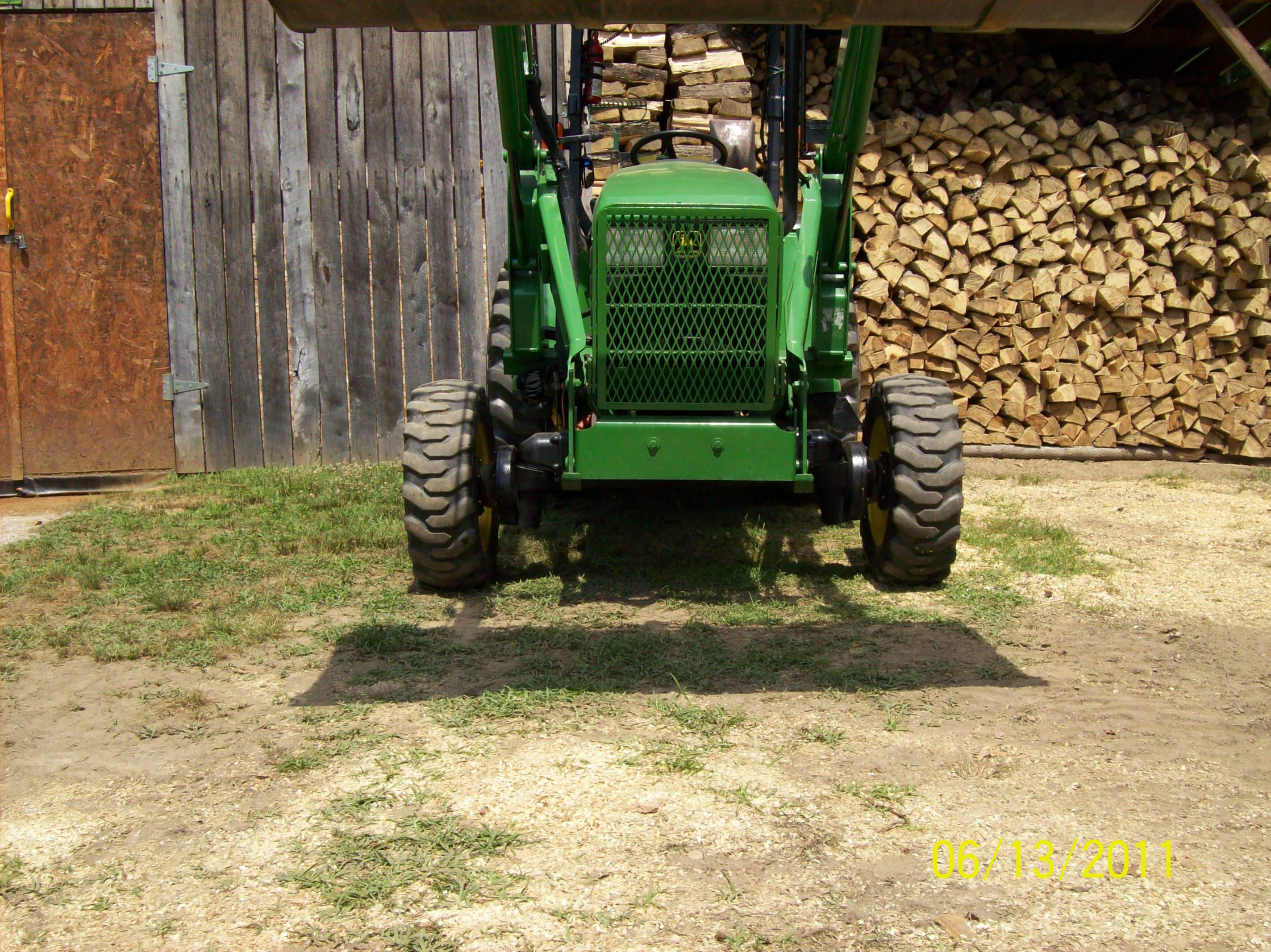

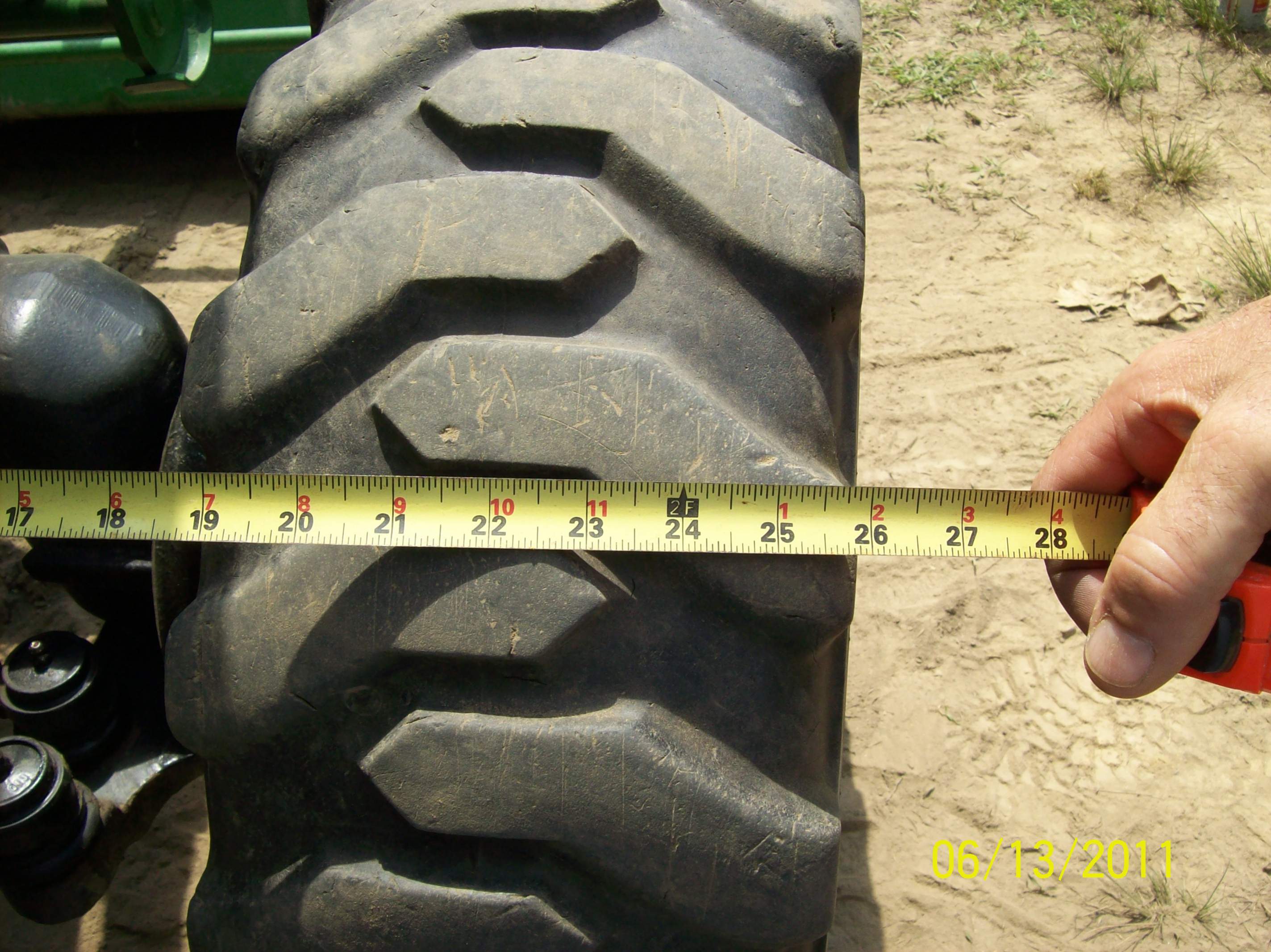

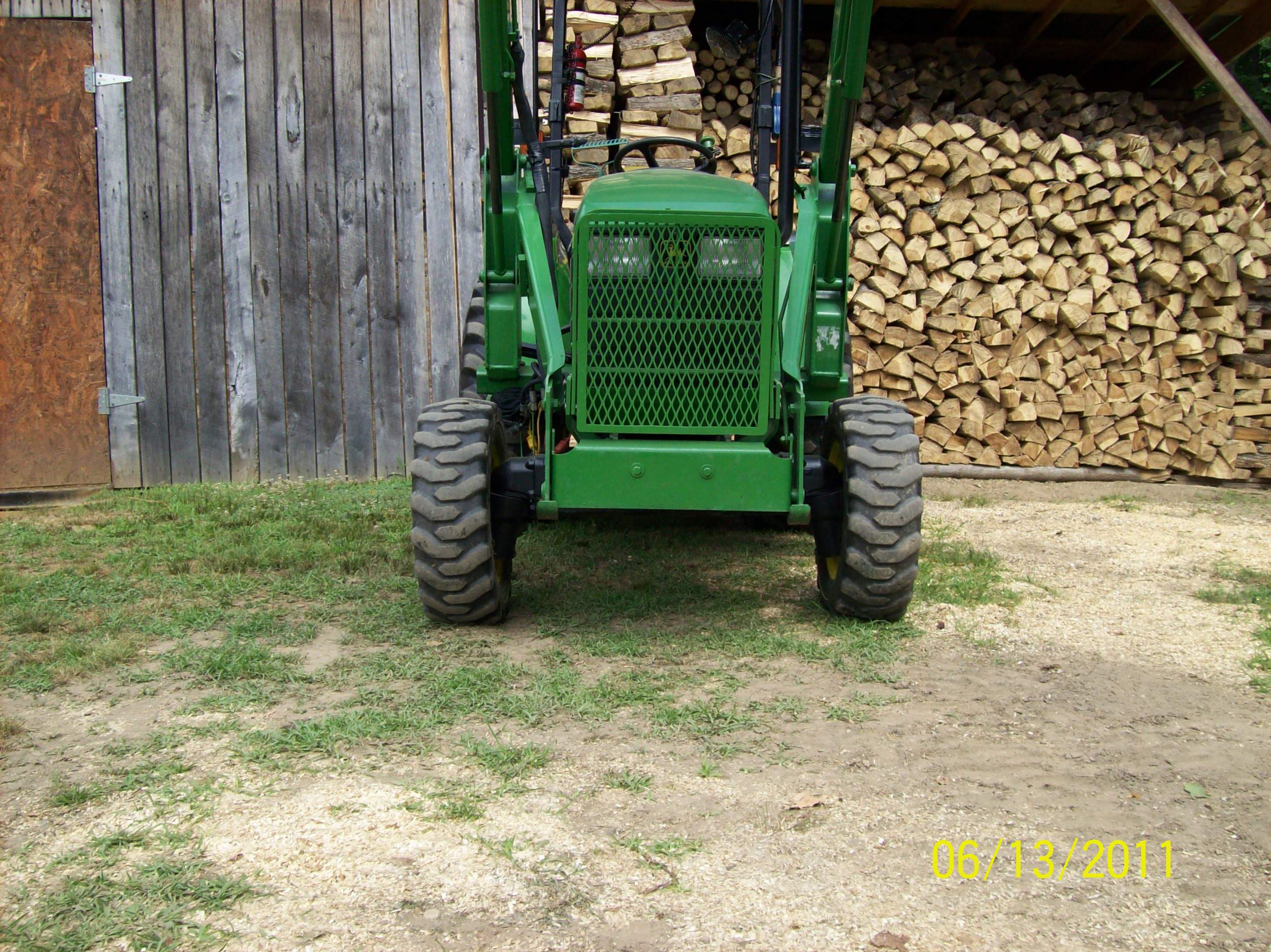

I flipped my rears several years ago!... Last year I went ahead and flipped my fronts.. I seen in my manual where it said the fronts can be switched to the wide position, So I did it and don't think I'll go back... I wish I would have done it a long time ago!
IF something should break, Then I'll just fix it... But I don't try to overload the front and I take care of my equipment the best I can!:)
Most of the time I keep my Backhoe on for Ballast, and last year I built a Ballast Box that's 2'x2'x2' and weighs 1,446 lbs!
Here's some pictures on the fronts before & after the switch... I raised my FEL up so the tires can be seen better.
Pic 1 ''before'' the switch.
Pic 2 ''after'' the switch.
The other two pictures you can see on the tape measure how much I gained... I measured from the frame of the tractor to the outside of the tire.
