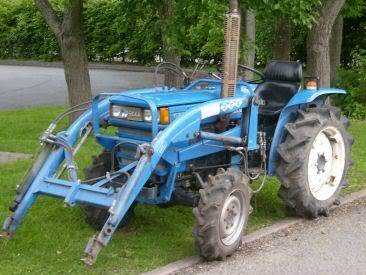

I've been inspired by the wheels on this thread. The guy fitted wider wheels to his yanmar. Looked the biz :)
http://www.tractorbynet.com/forums/yanmar/182371-1610d-low-wide.html
Here's my little 1610 on agri tyres.
The thing is my ground is very wet and wider tyres would be great. Looking through the bay of fleas as you do , turf tyres "look" wider, but are they actually? Anyway I would like to track down wider wheels /rims in the uk
my tyres say 8x22 on the back and 6-14 on the front. I think they have 6 studs.
The thing that got me interested was on the other thread someone said wheels from a vw beetle fit the yanmar so is there any such good fit for the iseki, ie landrover for the front or something? You know what I'm driving at ;)

There is a member on here with his Iseki in the UK who has double tires on the rear. That might be a good option for you. I had turf tire on mine originally, and they were a bit wider, but not anything noticeable. I would look at Yenebiz in Belgium, but with VAT and shipping, it may be an expensive option. Yenibiz en Mod Manuals, parts, spare parts for tractors Iseki-448 this the tread about the dual wheels that TBN member Marcle. He is from Herefordshire/Gloucestershire. http://www.tractorbynet.com/forums/iseki/249713-dual-wheel-adaptors.html You could look at Industrial Ag tires. In the US they are called R4's, but I am not sure what there designation is in the UK. I found a dealer in the UK who sells Iseki TS1610's. They might have an idea about wider tyres as well: Blacktrac Compact Tractors - Iseki Compact Tractors Their telephone number is: 01832 735680 or 07939 136207. Hope this helps a bit!

Wow, thanks for the detailed and would you believe it, that guy in the thread is about ten minutes down the road from me. :) Double rear wheels might be a good idea, give me more tread too. I thought the turf tires were twice the width ?
thanks again. will post pictures of whatever I go with. :)
