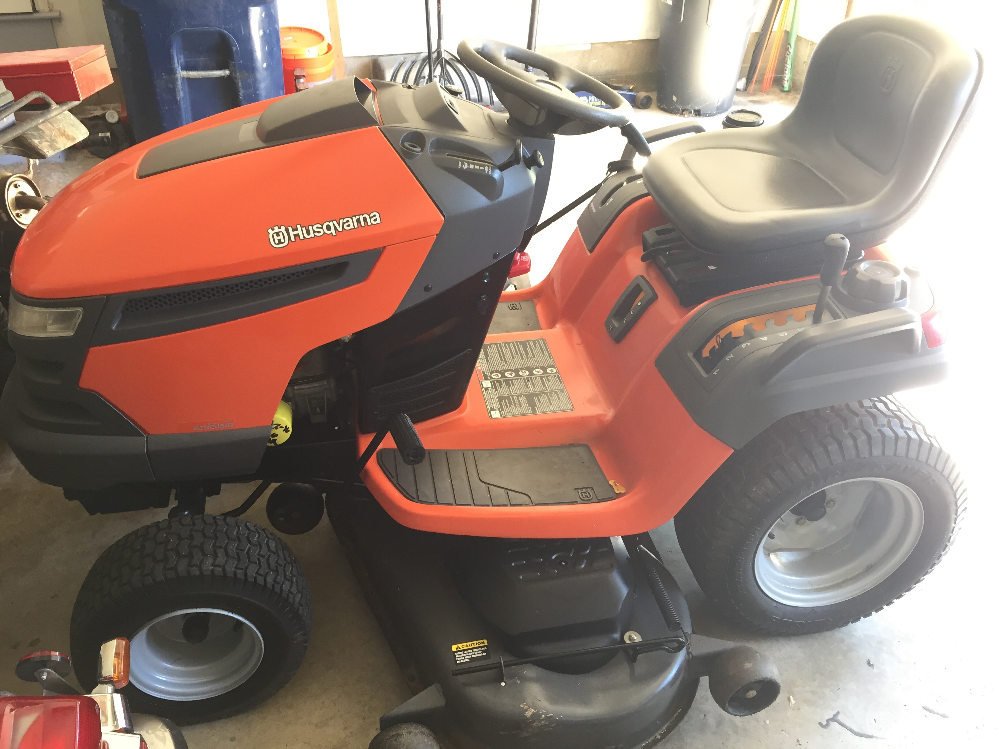

Husqvarna will be the best bang for your buck, you can get a 54in GT w/ deff lock for a tad over 3k, it sports a 24hp Kawasaki engine also. be sure to order one from a dealer and not a big box store, dealers models are heavier built.
I use a 54in GT for my mowing needs, it's a early 2000s and was bought from lowes, I bought it used off CL for $800. IMG_6314.JPG
