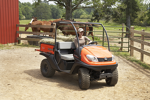

I've driven a few Kubota ATVs over the years, and all have had a single 2WD/4WD lever. I understand what's going on there.
My new RTV500 has one level for differential lock, and one for four-wheel drive. I believe that I understand the mechanics of the two levers. My default back wheel drive is one drive wheel, and the differential lock lever gives me two drive wheels in the back. The four-wheel drive lever gets the front wheels pulling.
So, I get that in snow plowing, I'm probably going to want both engaged to give me all the power I need. What I'm curious about is what scenarios, if any, would I want one lever or the other, but not both.
So:
  1. What scenario(s) would I want the differential locked on the back wheels but not four-wheel drive?
  2. What scenario(s) would I want the four-wheel drive on for the front wheels but not the differential locked in the back?
Thanks in advance for any replies! :)

Whoa! Stop the bus!!
People are on a tangent... and you do not understand your machine when you say:
The RTV500 is a Rugged Terrain Vehicle (and not a Quad Bike where you sit astride the engine/fuel tank.)
The Rear drive is the 2WD setting which gives you drive in T W O wheels with a differential. (Each wheel can rotate at differing speeds when cornering) No 'leaning needed' !!
Diff Lock "Locks" the diff and converts the rear drive into a 'solid' drive (Both rear wheels turn as one)
4WD adds the two front wheels as driving wheels eg. for muddy/soft ground. So you have F O U R wheels driving.
Never engage 4WD on hard ground such as concrete/asphalt.
Since the machine is 'new' to you go back to your dealer and get the Sales person to provide proper instruction of the various features.
:wrench:
