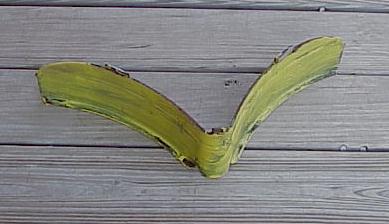

I corrected some of my mower side discharge problems by removing a piece of air flow inhibitor the enjineeers thought necessary and selling it as scrap iron.
