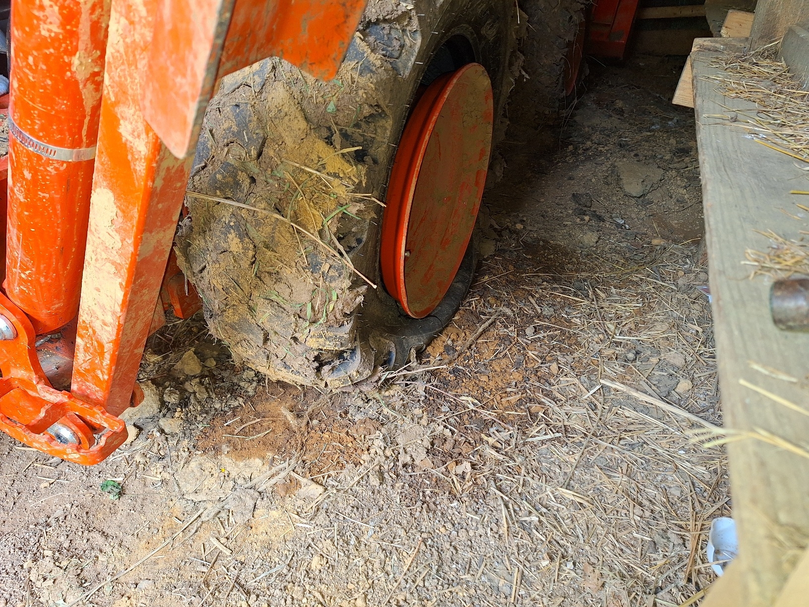

Where did you get a fill adapter at? I have to do one of mine after yesterday....the valve stem was loose, and
Nice muddy ground

So, I actually jacked the back up just a bit; taking pressure off rear tire when deflatting; then let it down where the tire was touching, and maybe 1" depressed from inflated; so the weight of the water was sitting on the ground, not trying to break the bead.
