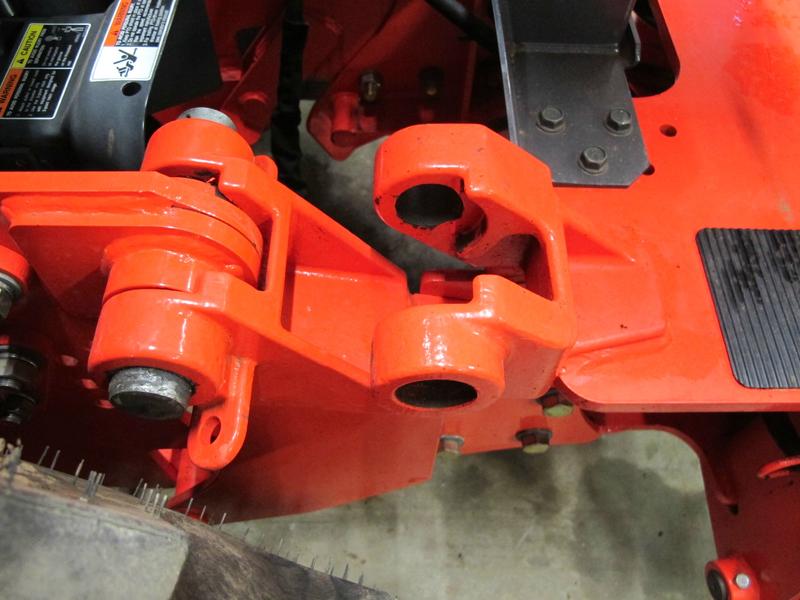

I had an older bh 90 for my 3130 and sold it with tractor when I bought the 5740 because they said it wouldnt work on a cab tractor. After getting the BH92 i only see a few differences. One being a curved stick, and the second is the spacer. I kick myself in the butt now because I think the BH90 would have worked. Just would have needed the spacer. I would order the spacer, put it on and try it. You will need a frame mount anyways for the tractor. Im willing to bet it would work.
I also bought the L2185 6' snowblower for my old tractor. Kubota said it wouldnt work. I bough anyways and guess what, works just fine. Im glad because after upgrading to the 5740, I would have sold the old 5' blower and bought the 6' blower because it handles it so well. I will tell you the BH92 is a beast compared to the 77 though.
   / Why no BH77 on Grand L with Cab and question on hydro noise #8
Here's the spacer you are talking about for the BH92. I was doing some research to add a subframe and 3pt backhoe to my L3540 non-cab model. I was just interested to see if this spacer would bolt up to my BH and attach to the subframe I installed. Unfortunately, it won't work for me...now, if someone finds a part number for extensions that fit a BH77, I'll like to know about it!
