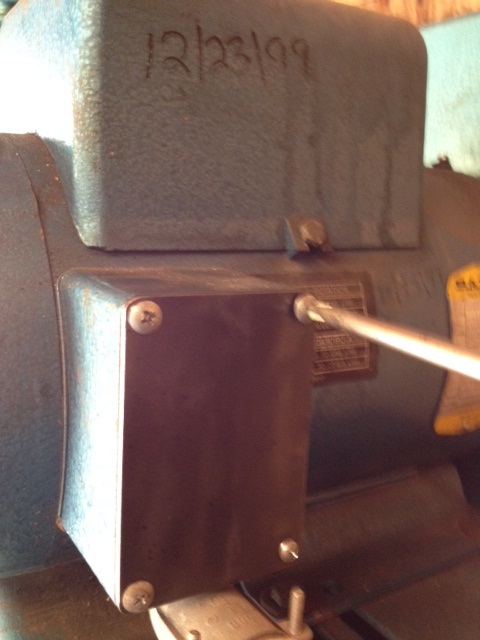

I have had a cnc machine with a plasma connected to it for over 16 years in my home shop......which is just a hobby operation. Repairs around the ranch, parts for the tractor, for hot rods, most often parts for buddies projects. Occasionally I even make something nice for the wife.
Today I was puttering in the shop and I remembered that after installing my new used (Craigslist bought) air compressor ...that I didn't have the cover for the motor wiring box.....it was missing when I got the compressor. I thought I would put a little picture story of how you can save a trip to the hardware store, and save time fabricating even the simplest of metal parts with a machine like this. Granted, jobs like this won't pay the $15k I spent (over 8 years ago) for this current machine, however trust me, this machine has already paid for itself a few times over!
Photos:
1. The missing cover
2. Quick measurements
3. Draw in CAD, convert to cut path, less than 2 minutes total.
4. Start the cut
5. Finished cut. less than 35 seconds total.
6. Top, clean.
7. Bottom, some dross. I think if I was cutting a few I would tweak the speed up slightly....faster equals less dross.
8. Removing the dross with my favorite tool for the job, concrete chisel. Dross removal, 20 seconds. No need at all for grinder. This is 12 gauge steel.
9. Its on (needs paint though). Total from measurement to installation less than 10 minutes.
Easy to learn, easy to use. Low cost cnc plasma. No, my company does not make the cnc machine.....there are about 26 in N. America that do. This particular one is a PlasmaCam with one of my companies plasma's mounted.
Jim Colt
photo 1.jpgphoto 2.jpgphoto 3.jpgphoto 4.jpgphoto 5.jpgphoto 6.jpgphoto 7.jpgphoto 9.jpgphoto10.jpg
