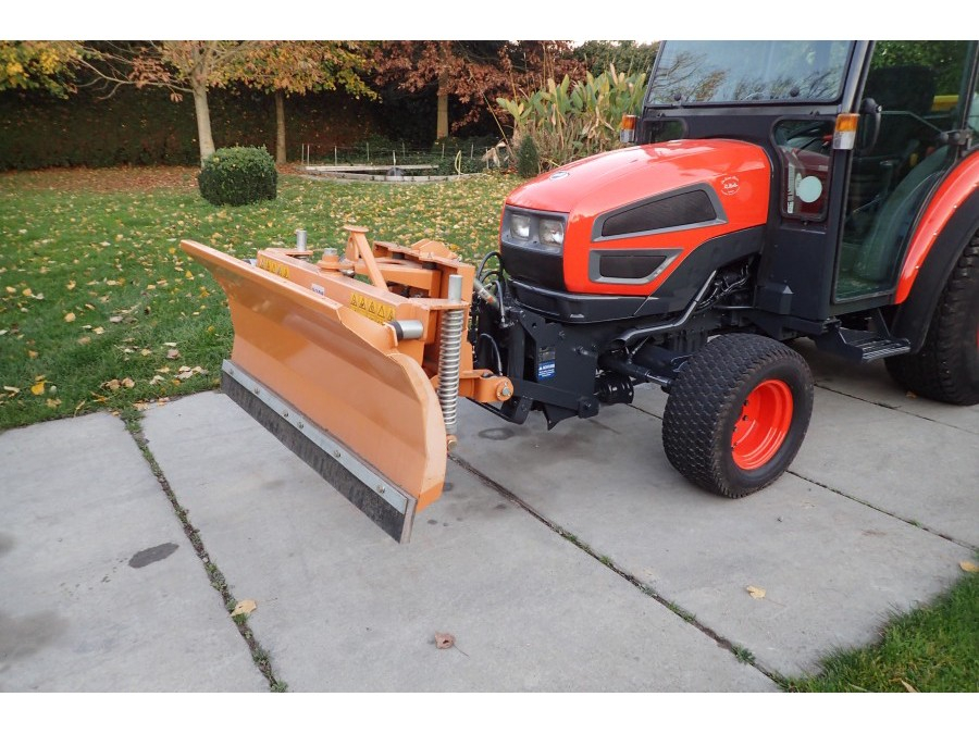

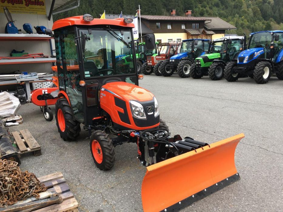

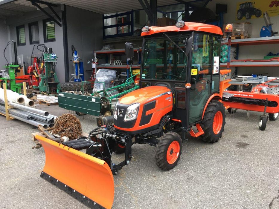

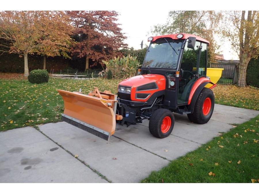

Or just offer the front 3 pt hitch plus front PTO and have a wide variety of 3pt attachments already available, instead of relying on the proprietary mounts for proprietary and expensive attachments.
In Europe, although it's a dealer installed option, there are front 3 pt systems plus PTO available for pretty much any tractor brand starting at 25 HP or so.
