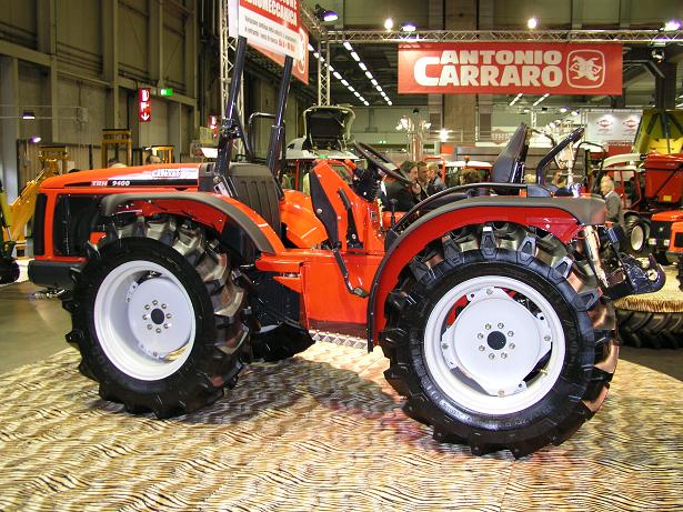

Saw this in The Field Guide to JD Tractors that I bought recently. It shows JD tractors all over the world (not green in Oz). The ones pictured as Goldinis had the same size front and rear. May be an Italian thing.

   / Why do vinyard tractors have 4 large tires? #6
Tractor on picture is Antonio Carraro, not a Goldoni, and has steerable front tires (it is not articulated). All wheels are equal size.
These tractors have bigger weight on front axle then on rear axle (60:40%), and need bigger tires for that load and stability.
When they PULL implements, main traction came from FRONT tires. With implements on 3pt raised, it has equal load on both axles, so it give them top stability on slopes.

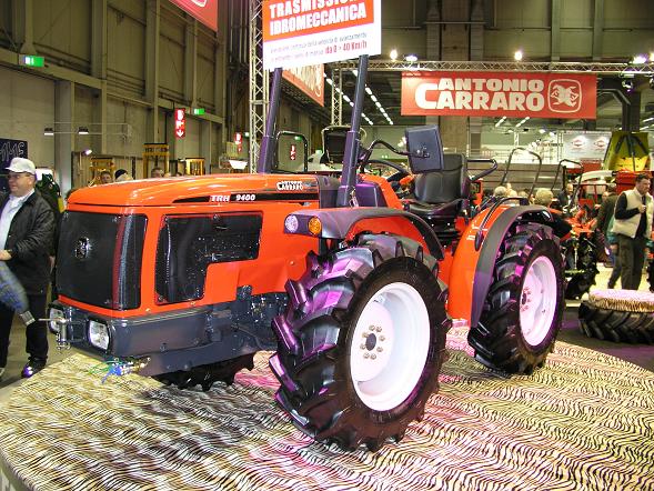

   / Why do vinyard tractors have 4 large tires? #7
Rox,
If I remember correct, you have a good Goldoni tractor there on your property.
Some of their models were sold under JD name, as well as their model Star 70 use DPS (JD) engine.
