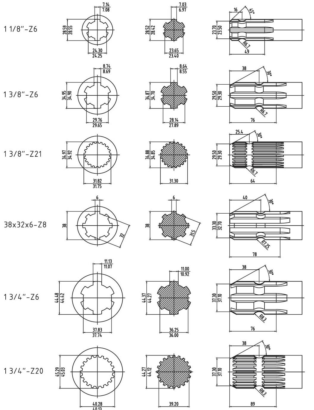

Basically the title - Why do all PTO drive shafts have grooves? The groove radius varies a little, from 6.7mm to 8.3mm (6.8mm to 8.4mm according to the book I am reading).

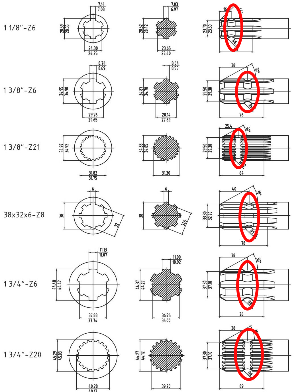

Thanks. I case I haven't made the question clear. These are the grooves that puzzle me:

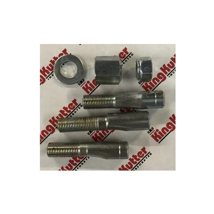

That groove is to lock the collar onto the shaft. Some collars have a spring-loaded pin that you have to release to get the collar on and off. Other collars (usually the ones on the implement end, meant to be attached once and stay there) will have a tapered and threaded pin that you drive through the hole and groove and lock in with a nut. This is what that pin would look like:
