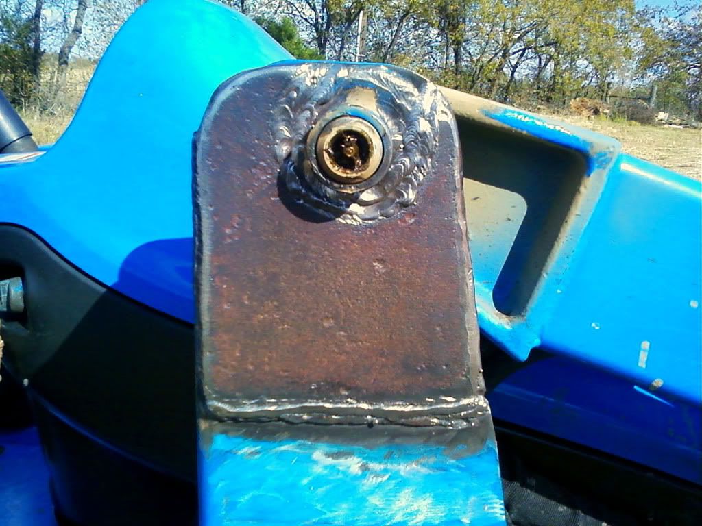

Like Jim, I have a NH heavy duty bucket and purchased a reversible cutting edge. My tractor gets used hard since it has to make money.
I was grading out an old dry clay field berm for a customer last summer, taking a little bite off of the berm in each pass with the edge of the bucket down to grade, when the top of the fel tower broke off. Here it is after the repair.
It turns out that the bung wasn't completely welded all the way around, but the factory paint was hiding the flaw. I know it wasn't visibly cracked at the beginning of the day since I grease my tractor daily.
I will be purchasing another heavy duty bucket with a removable tooth bar before I take on a project like this again so I can use the full bucket width and take the twisting strain off of the fel arms.

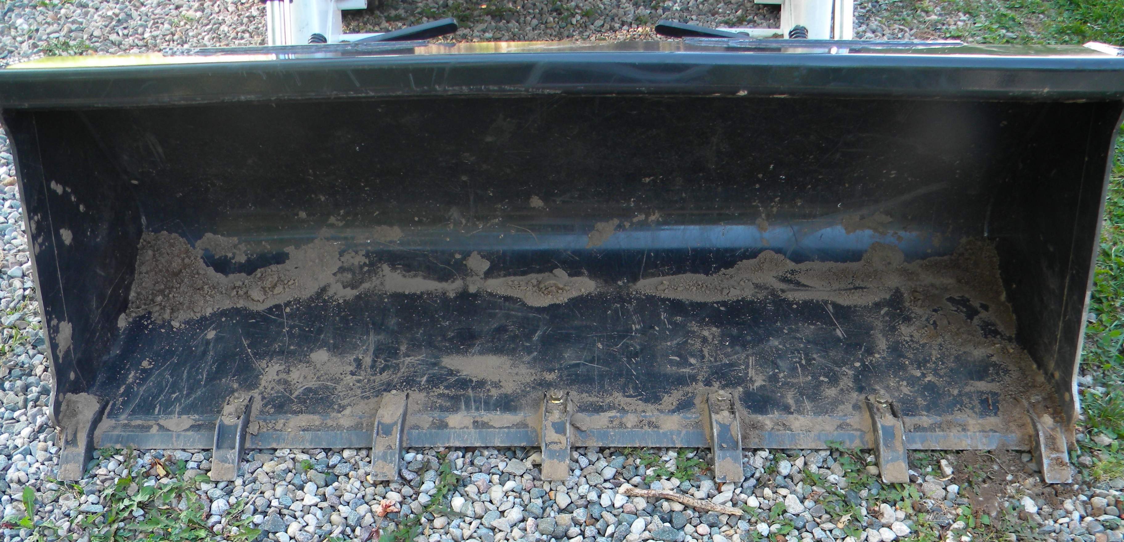

Bobcat tractors offer a bolt-on tooth kit with hardware for about $90.
