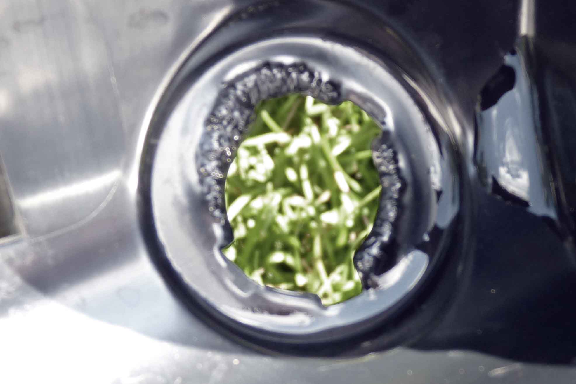

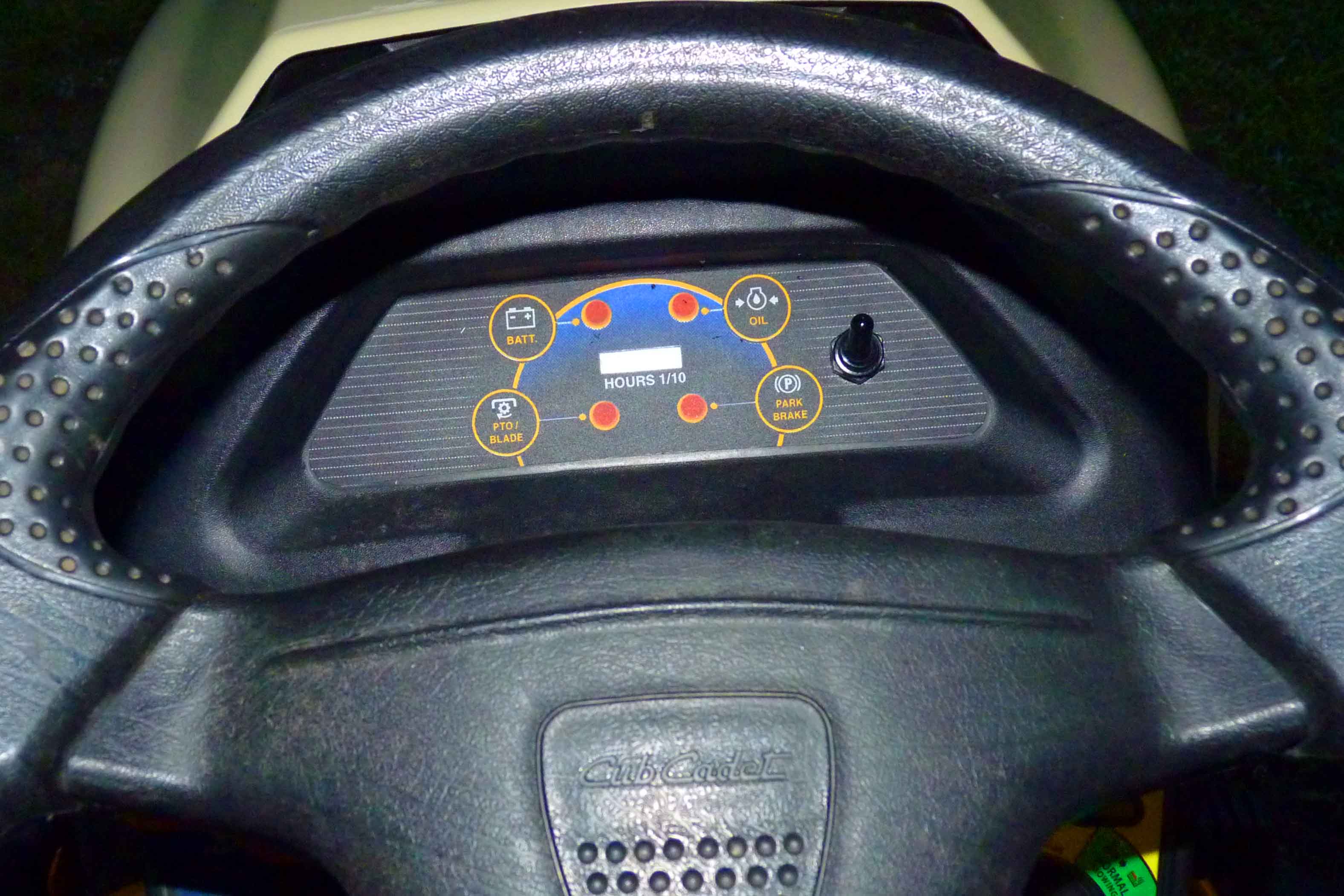

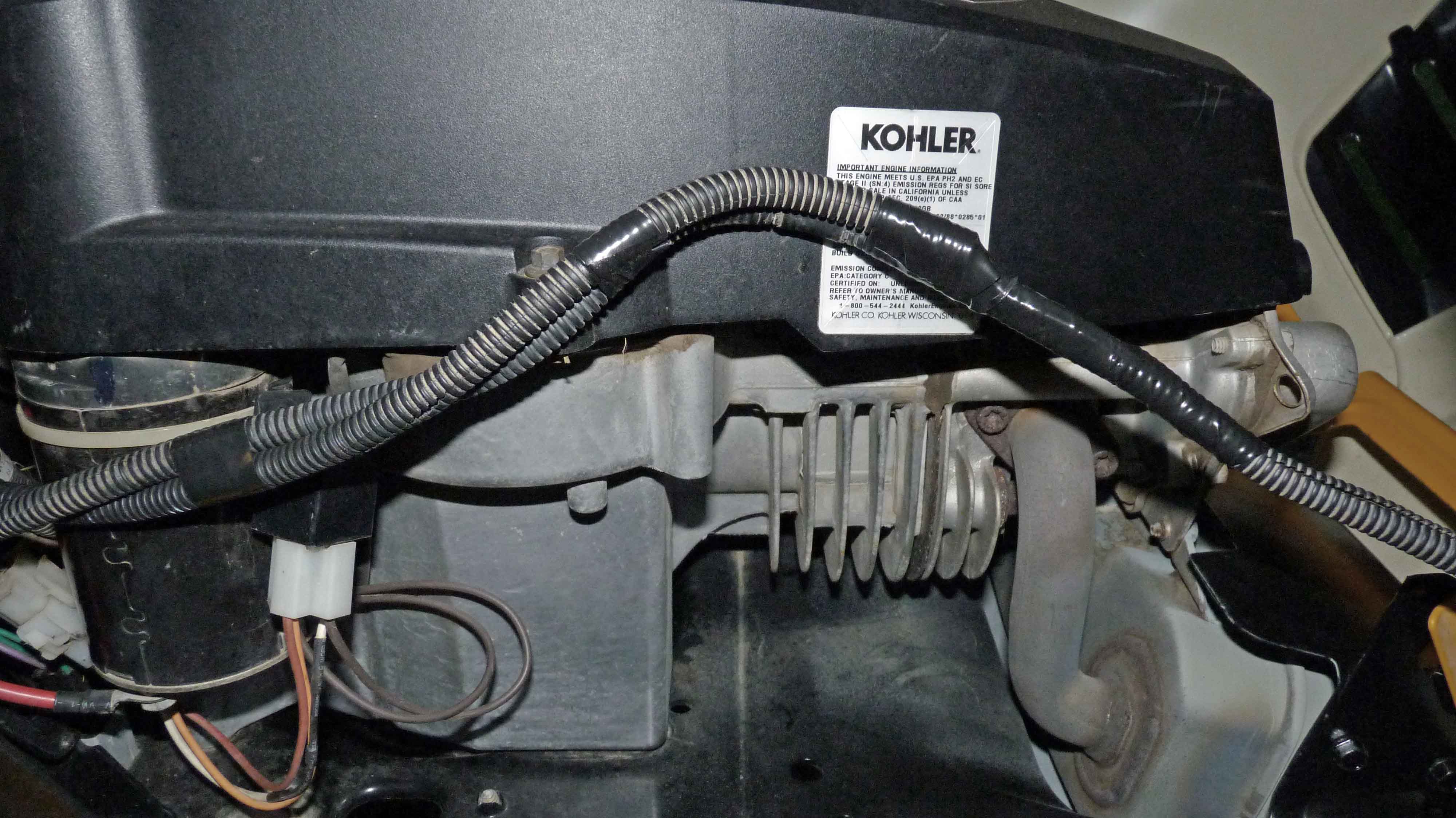

My 2010 LTX 1045 just turned 100 hours. After servicing (Oil, Oil Filter, Air Filter, Gas Filter, New Blades, Complete Grease Job) I decided to clean the headlight lens. On this model, there is no switch; the headlights have been on for 100 hours. I was surprised to see melting of the plastic at the socket locations. See attached pictures. CubCadet Light Socket.jpgCubCadet Switch.jpgCubCadet Wire Switch.jpg The additional of a switch should keep the issue from getting worse.

That is about the easiest thing in the world to do, put in a switch similar to the toggle switch on the dash now for the lights. Replace the melted light housing to prevent shorting out later.

2nd easiest. I could have just clipped the hot wire and taped it. The factory assembly was superb! It is still like new. When delivered, all the specs were right on. At 100 hours, they still are.

Dean - some time back, CC did have a dash light switch position incorporated into the ignition switch. When they introduced the RevTech feature, they decided to use that ignition position for it and at the same time full time power the headlites with a separate AC circuit coming directly off the engine alternator, running all the time (no switch). Idea was to keep mfg cost down.
I think a good number of the other mower mfgrs did essentially the same thing around the same time....
Like yerself, I would just break the circuit instead of drilling holes in the dash and running more wiring, etc. .....
   / Why All LTX Models Should Have A Headlight Switch
Always have plenty of wire, crimp connectors, and toggle switches laying around. Also had some of that flexible conduit from some wires that must have fallen off from under the seat a couple of years ago (the only thing that fell apart on this machine ;)). The dash location was easiest place to install the switch; out by the first socket was the most convenient place to clip & crimp in the switch wires.
