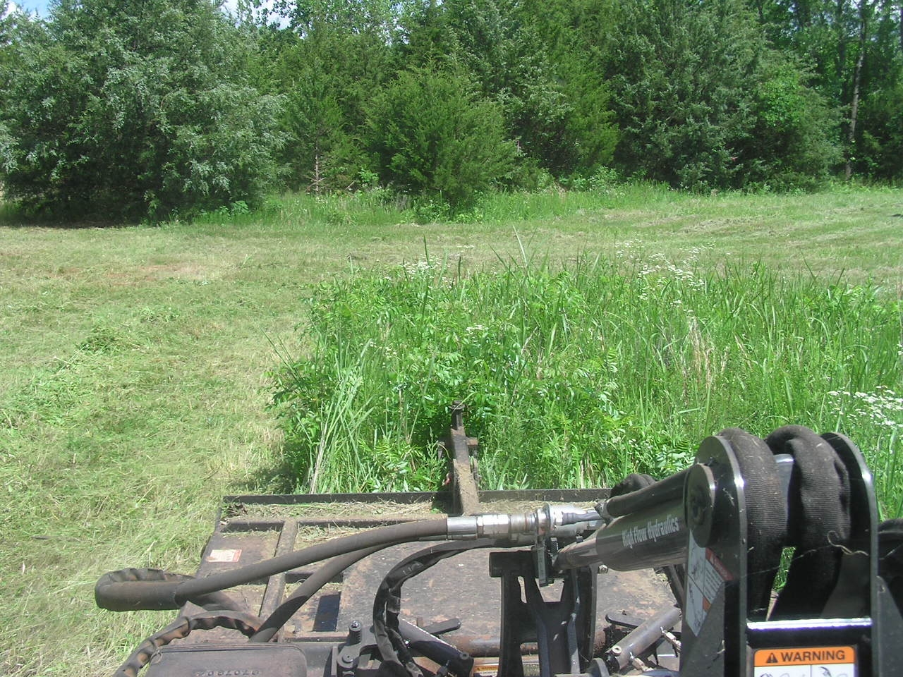

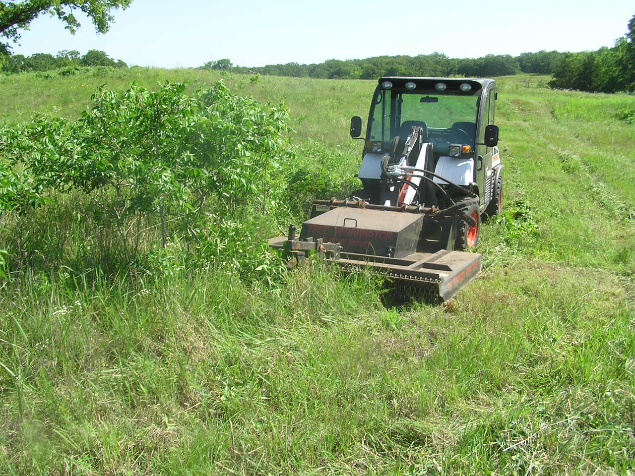

   / Why 3pt Rotaty (brush) Cutter vs Quick attach on FEL? #7

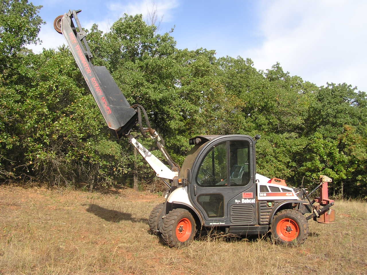

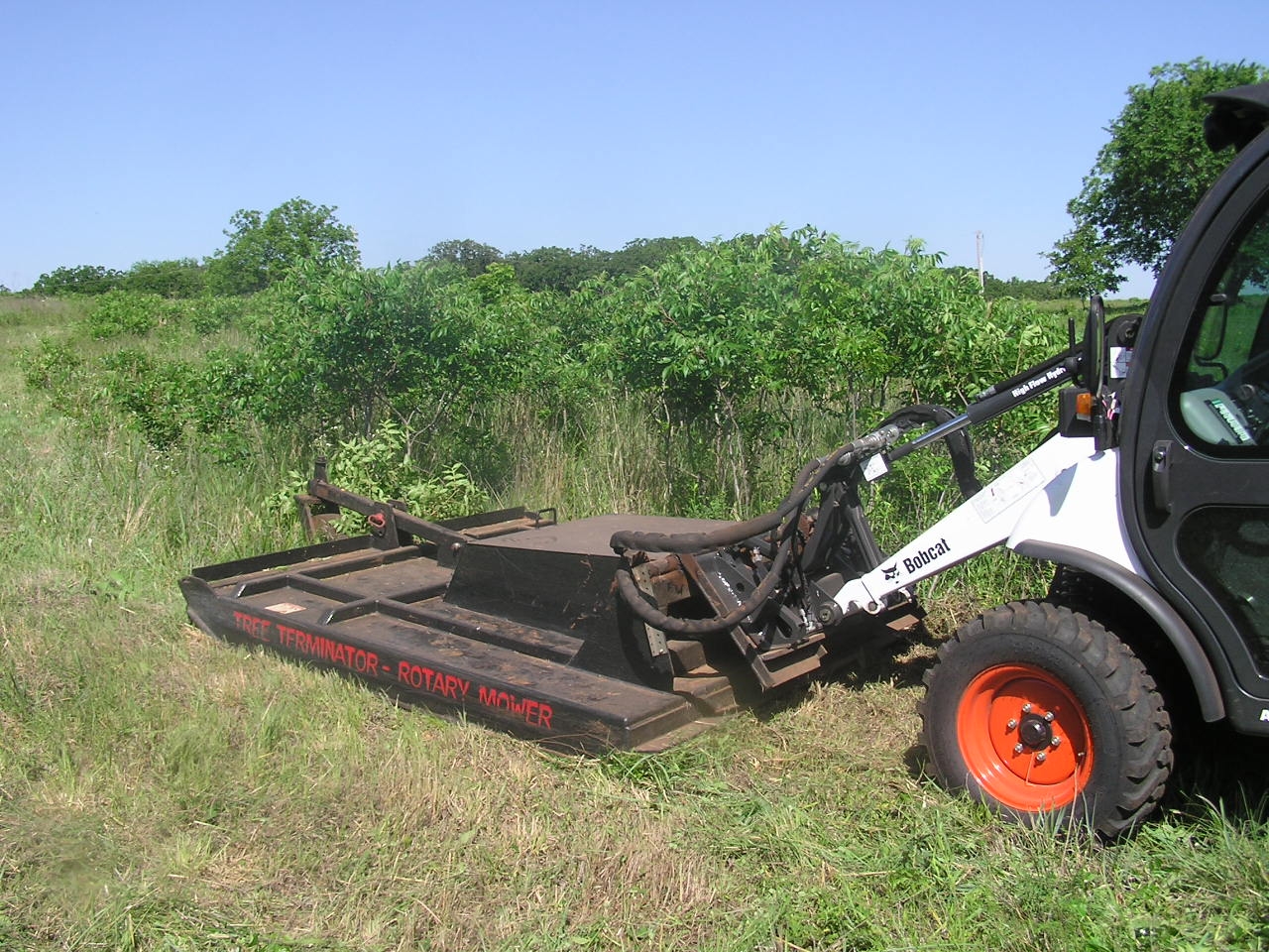

The out front 7' brush hog works great on a Toolcat:
The view from the seat:
Limb trimming mode:;)
