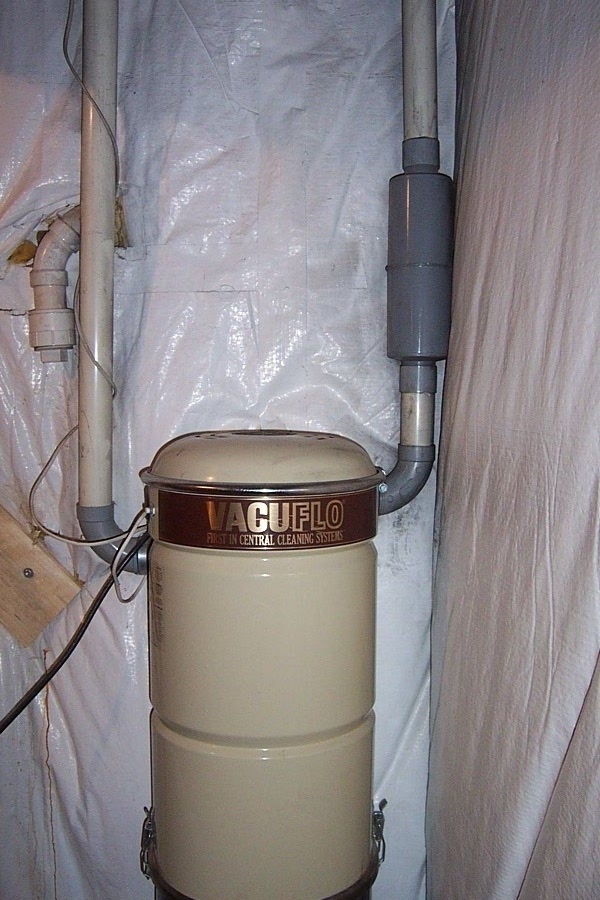

Here a pic of our VacuFlo 26 unit. It was in the house when we bought it. That's 1.5 inch PVC.
We loved it for the first 3 months living here. Now, however, after 1.5 years we almost never use it. Moving the hoses seems like more work than moving a portable sweeper or vacuum cleaner!
Just my 2 cents.
