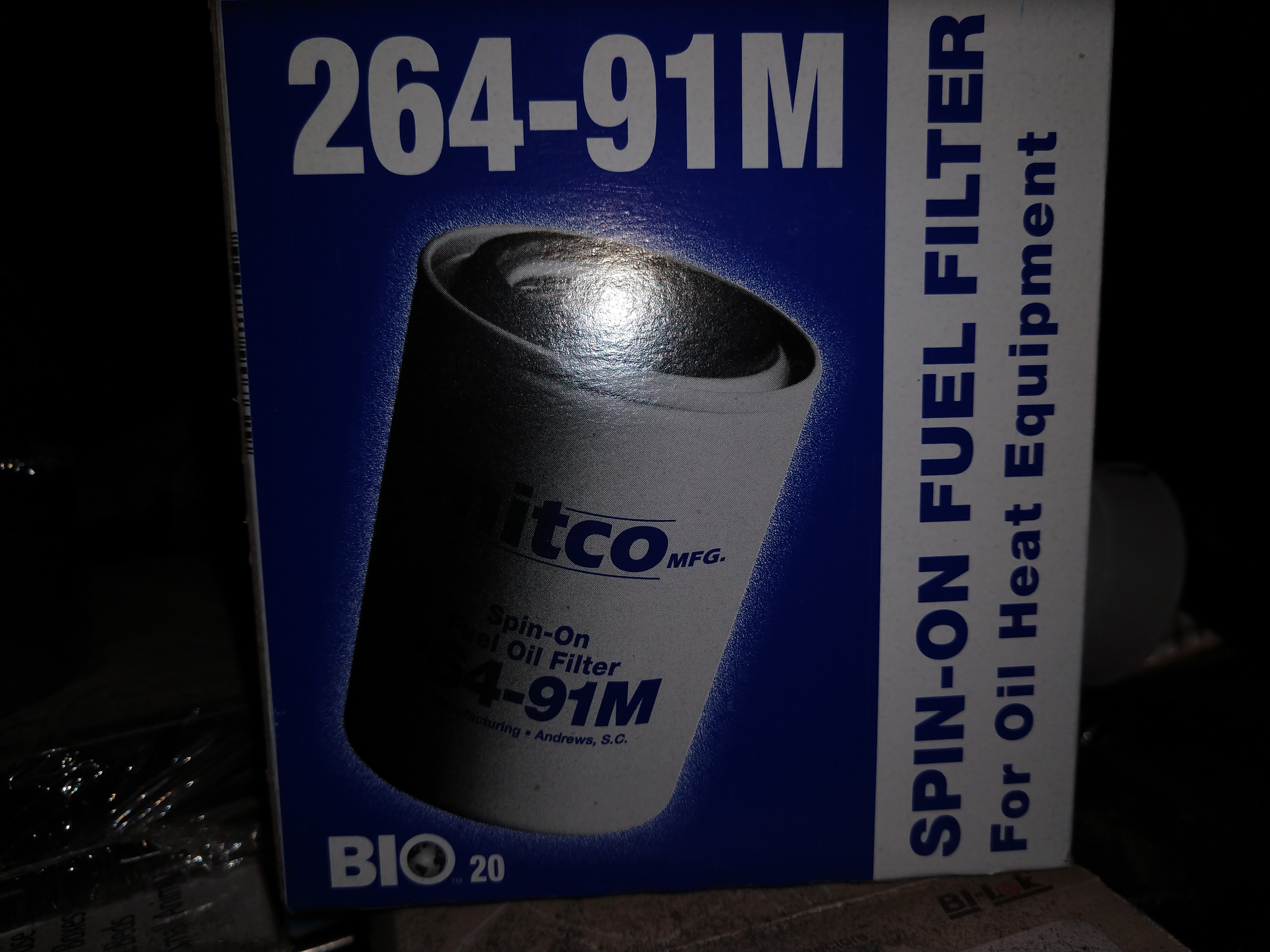

Hi there, this might not be the right cat for this but Im wondering if anyone has this type of spin on filter on the oil furnace line?
http://generaloilfiltersdirect.com/pdfs/oil-2011-prices-page10.pdf
I finally found this listing but couldnt get further in the search to find a reasonable place to find just the oil filter spin on part.(without the mount).
this was originally installed by an oil company. I like the idea of spin on filter but think that they use it so they can be the only place to get filters.
Dont want to but I might have to change it back to the 'normal' filters of years past. they are only 4 bucks at HD.
thanks .

Turn off the fuel, put a can under the filter, and take it to your local NAPA dealer who may be able to match it to something by Wix.

They are generaly avilible at most places around here;
or Amazon.com: General Filters 265 R Replacement Cartridge, 45 gph, For Use With Gar-Ber Spin-On Fuel Oil Filters, Epoxy Coated: Industrial & Scientific
If you download this catalog you will have lots of part numbers for every thing on your boiler.

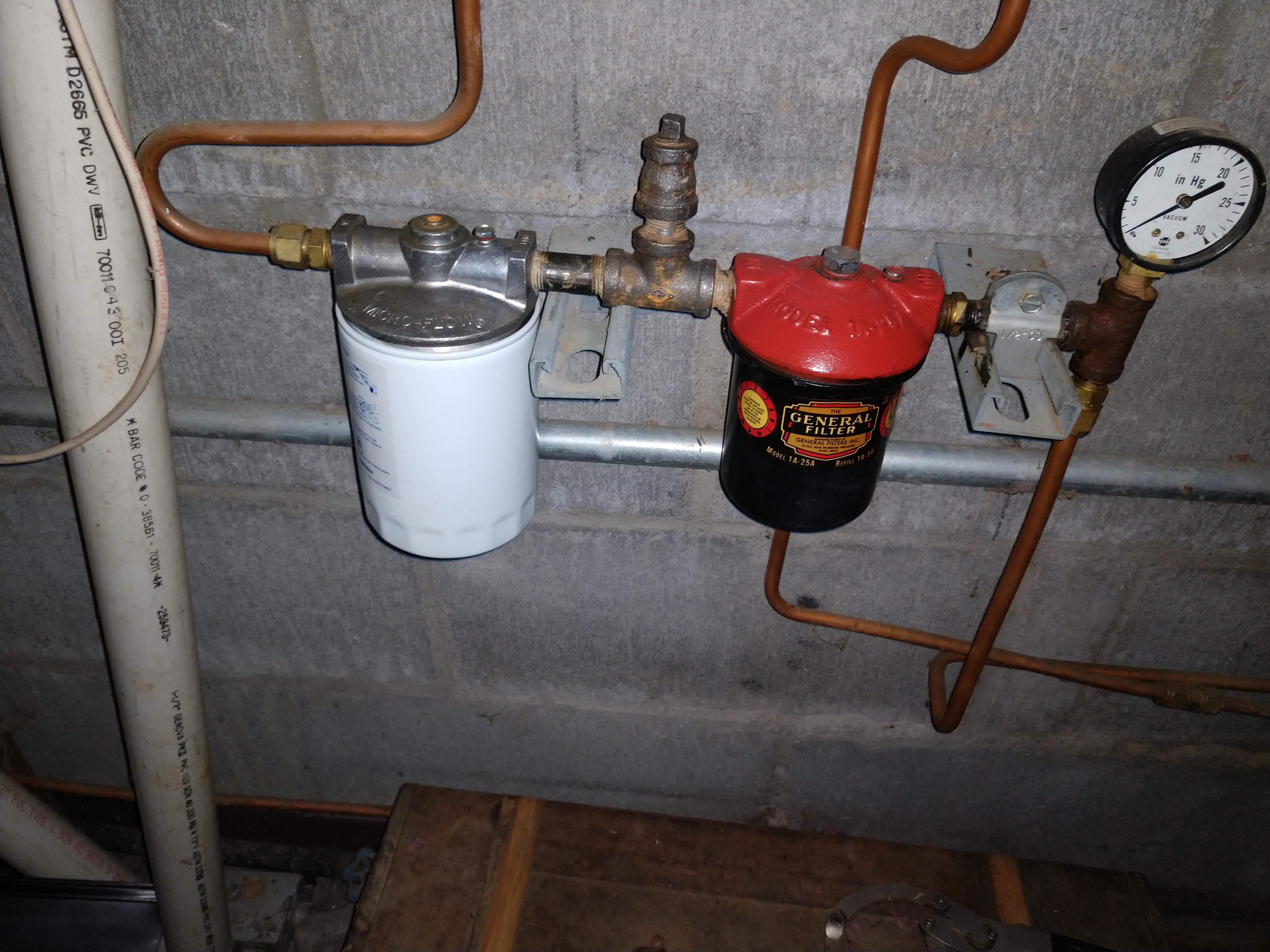

I just went downstairs and got a photo of mine, I'm running two filters in series and I do annual changes.
I also change the nozzle and ignitors every other year, which is about 2000 gallons.

Home Depot also has those spin on filters. I keep about 2 on hand all of the time as my tank is getting older and it direct vents to the outside.
