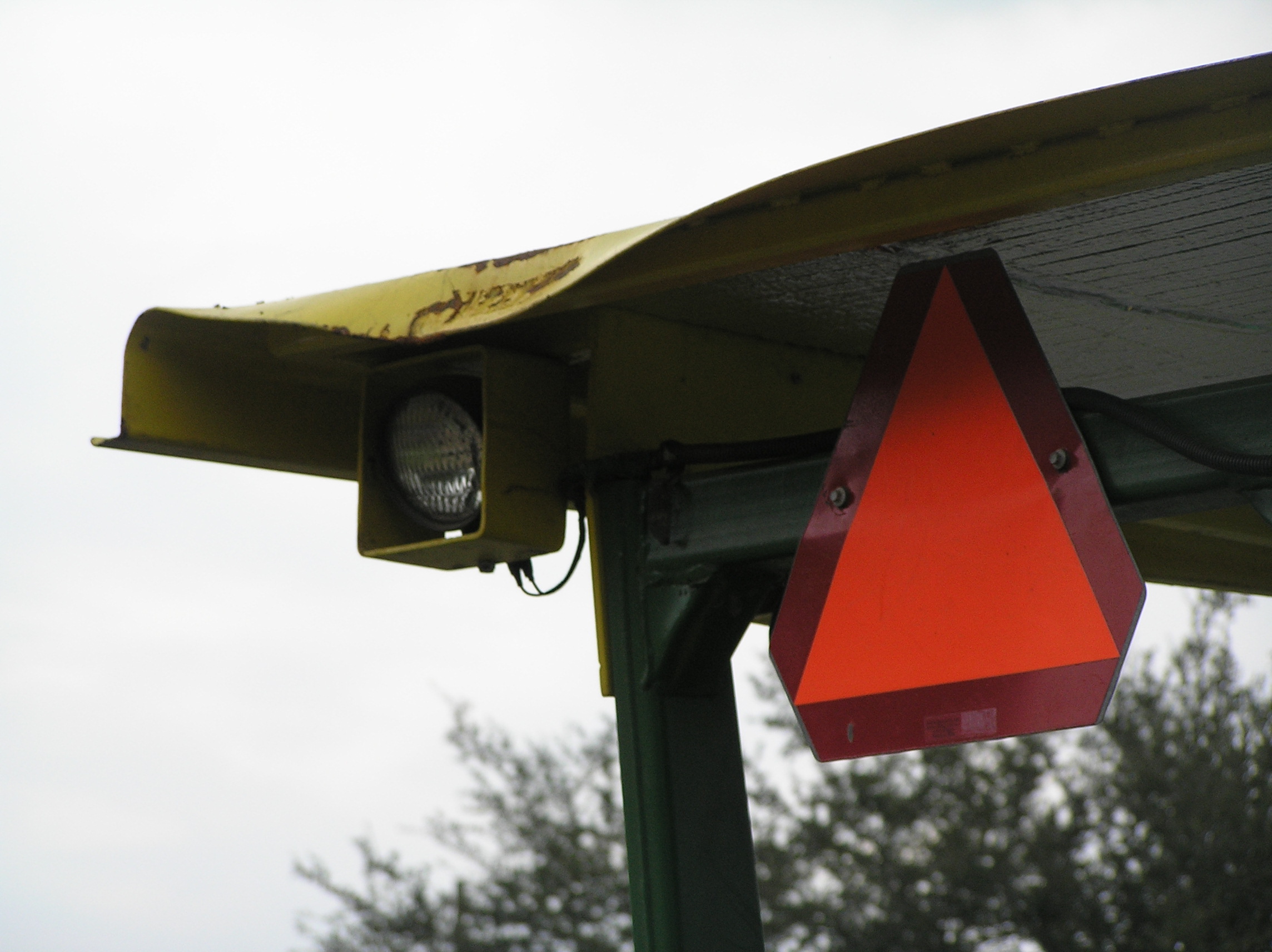

I felt as though everything was happening in slow motion, but I couldn't move. I watched that pipe hit about 18'' above my head and about 12" back. The attached pictures tell the story. Another 1/2" or so, and I wouldn't be here to tell you about it.

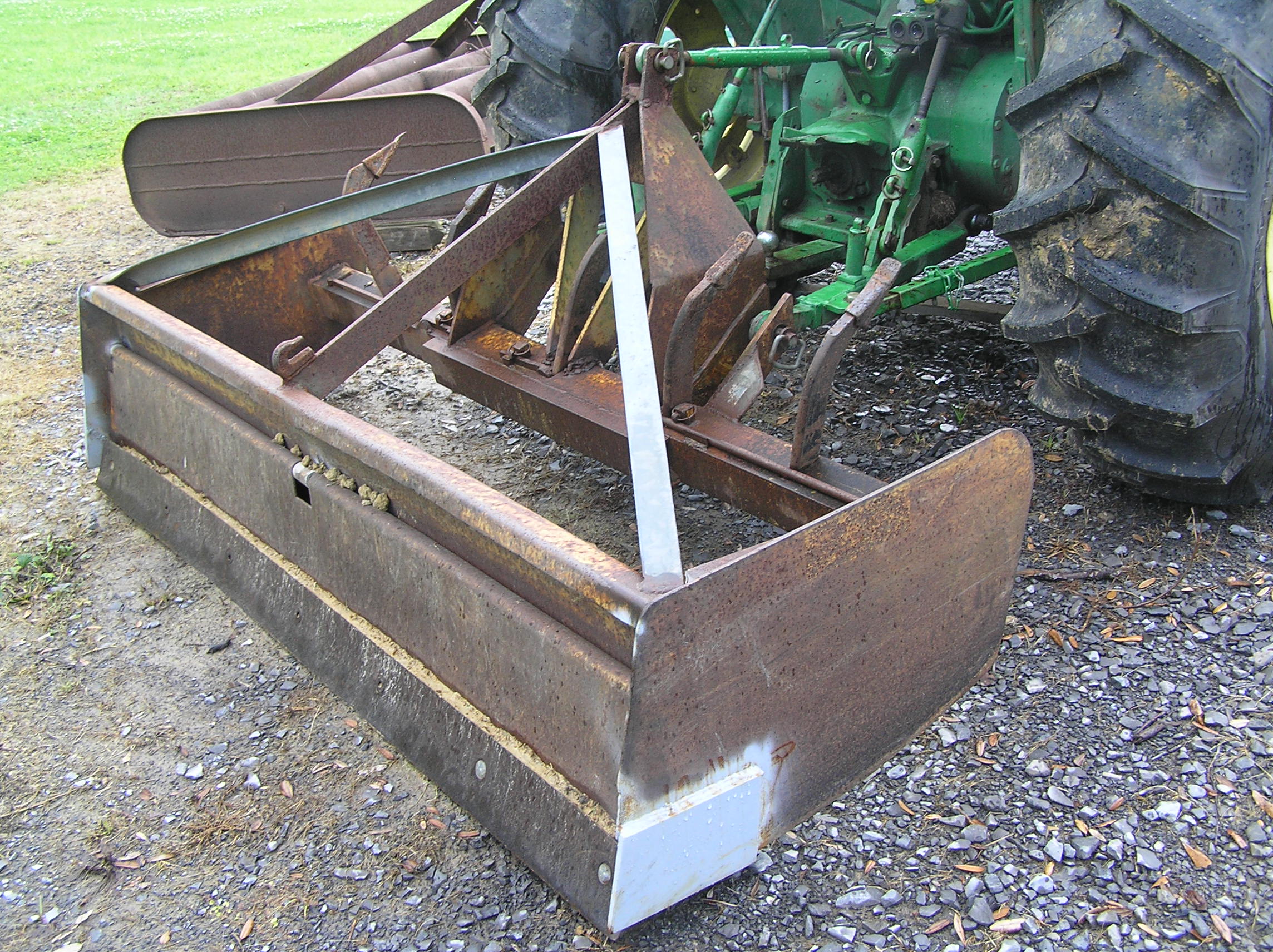

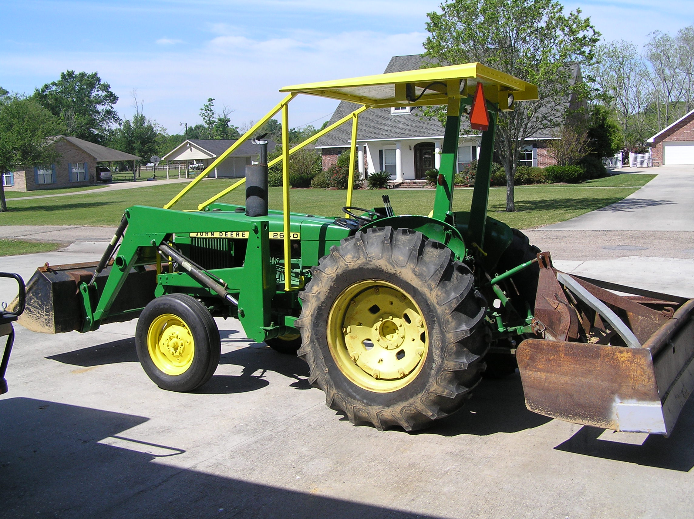

These two photos show the tractor and BB.

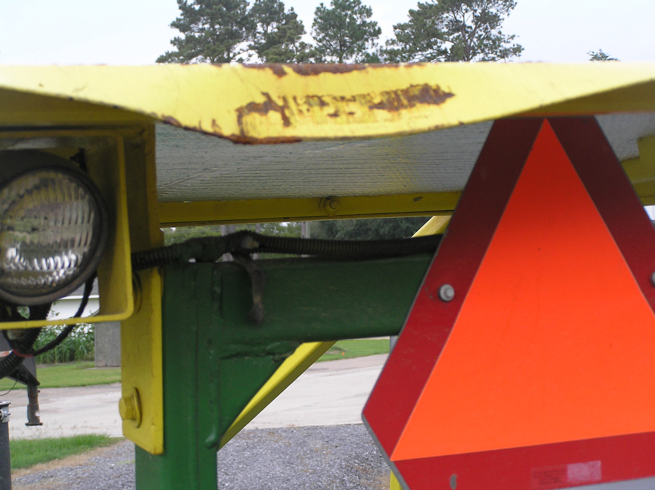

These two show the damage.

Looking at where the canopy bent, I have surmised that the pipe would have missed the rops and would have hit me at the junction of my neck and right shoulder. Wouldn't have been pretty. I'll try to take a picture from another angle to show what I mean.
