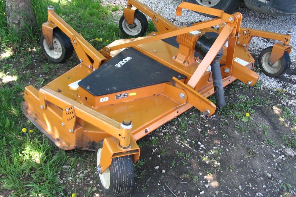

For almost 20 years I've been using Woods RM990 mowers. They have three spindles (enclosed belt drive), 7-1/2 foot cut, floating on 4 castors, with hinged lower links. Weight is around 1200 lb. The high-speed blades leave a finish cut on grass, but are thick enough to handle light brush. Woods says it will work with 25 pto hp but I find 35+ works much better. The 6 blades are pinned free to swing back if needed without breaking anything. I've had three 990's and still have 2 - great product. Not aware of anything directly comparable for strength and commercial build-quality. I think it would be very well-matched to an L5240
