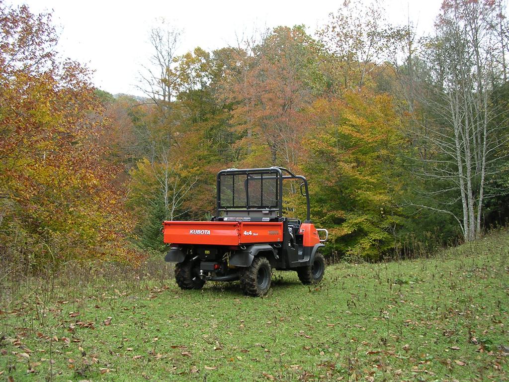

I would definitely recommend you test drive a Kubota RTV. The worksite model includes the hydraulic dump bed with a cargo bed load of 1100 lb. Also the RTV has power steering as well as the hydrostatic transmission. Although it might not have as high of ground clearance (7.5 inches at rear axle) as the Deere that should not make quite as much of a difference if your concern just involves crossing water as opposed to rough terrain. What you may look at is the location of the air filter housing and see if that is high enough on the RTV. The Deere owners speak highly of their machines and if a dealer had been nearby I may have gotten one myself but I have been very happy with the RTV so far. It is built like a tank and weighs almost as much as one! Also it is a diesel.

Was typing my first reply when you posted more information regarding your possible uses. The manual I have shows a towing capacity of 1300 lbs. I have not used it for towing yet but have had the bed weighed down pretty good with some 12x12 timbers I used on a project and it came up the mountain with them like they were'nt even there. One other observation I have made is it seems to sip fuel. I have attached a photo so you can kind of get an idea on clearance with the standard setup. You may also be able to make out part of the tubular frame where the rear hitch is attached.
