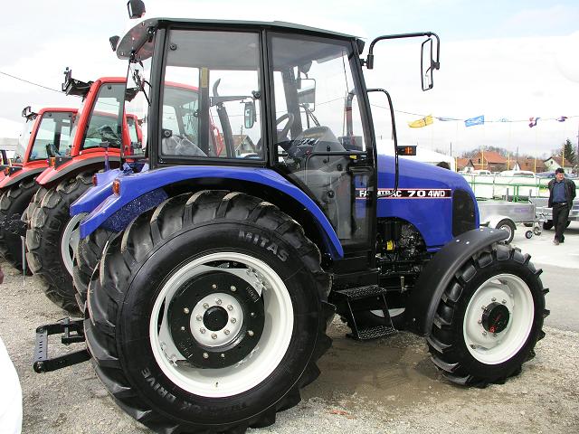

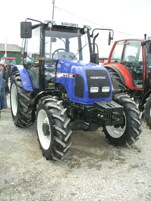

Some of the bigger Farmtrac models are produced in old Ursus factory in Warszawa, Poland. Smaller has Polish gearboxes ...
   / Who makes Farmtrac tractors? #6
... and bigger uses Carraro gear boxes ...
   / Who makes Farmtrac tractors? #7
... and Carraro FWD axles.
   / Who makes Farmtrac tractors? #8
</font><font color="blue" class="small">( the bigger Farmtrac models are produced in old Ursus factory in Warszawa, Poland. Smaller has Polish gearboxes ... )</font>
Interesting ZJ_HR,
I wonder if it depends on the destination country where the products are made, and with what components?
   / Who makes Farmtrac tractors? #9
Yeah, those versions of the FarmTracs are not the versions the US recieves. The ones we recieve have the older "ford" look to them, and CAB models are not available yet.
