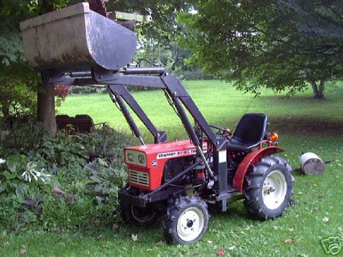

Looking to see which mfg carry a loader that will mount up to a Yanmar 155,Didnt see anything with Woods and Koyker only lists the Grey's.Thanks n advance

Yanmar makes a YM155 and an F155. I suppose you are speaking of a YM, and the YM1300 is the gray equivalent to the YM155. Dead ringer almost, and the loader is a bolt-on. The Koyker 80 is the way to go.
If this is a 4wd, keep in mind that the front axles on these aren't real tough as they really weren't designed for a loader. If it is a 2wd, it will be dissapointing with a loader due to weight transfer off the back wheels.

Leon also makes a loader that will fit the YM155.

I would try the CTC loader. Mounted one on a 155 and it was excellent. The loader is very versatile and is an excellent fit with a lot of versatility.

I have a KwikWay on mine. Kind of light but the tractor is not really heavy enough to do any real hard digging. Be careful of the limitations or you can break things.
