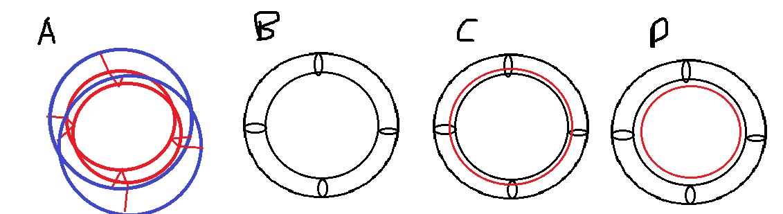

see attached diagram...
A = rim (blue = outer edge were bead of tire goes), (RED = inner diameter of the rim)
B = TUBE
C = rim (red) is bigger diameter than TUBE inside diameter.
D = rim (red) is smaller diameter than TUBE inside diameter.
i can understand streching over the outer edge of rim (blue). but...
seems you are saying you are having issues with C. and tube inside diameter = to small. or am i missing reading what you are saying?
so question is... is manufacture of tube mis-labeling tube sizes? stuff gets messed up all the time on different specs on large amount of products out there.

I suppose it could have been a mislabled tube but my guess is there's one or two factories in China or Korea spitting these out and anyone who wants to can buy them and put their name on them. The TSC tube took two hands to stretch it enough to get into onto the wheel. Once on it was so tight on the smallest part of the wheel that it was very difficult to slide to line up the valve stem with the hole in the wheel. I took my front tire from my Kubota to a local tire shop but this one is pretty heavy. It's fine just rolling around but not something I would want to lift. I haven't used my truck in about 3 months and let the inspection lapse (I accidentally cut one of the wires going to the ABS sensor so I just ordered a new one to pass inspection). Since the tire is too large to go into any other vehicle without a lot of struggling I really would have to wait until I get the truck road legal before I could get the tire fixed.
I've never had issues with tubes before. I've done thousands of motorcycle and bicycle tubes. I've even replaced both rear tires on my backhoe, the tire alone weighed almost 200lbs, and had no issues with the tubes. I even drove over a nail with one of the front tires and had to remove the tube to patch it with no issues. What I don't know is if Case got tubes specific for a 16" wheel vs the 15"/ 16" tubes everyone seams to sell now or if the TSC tube was unusually small. I'll know by the weekend and report back.
