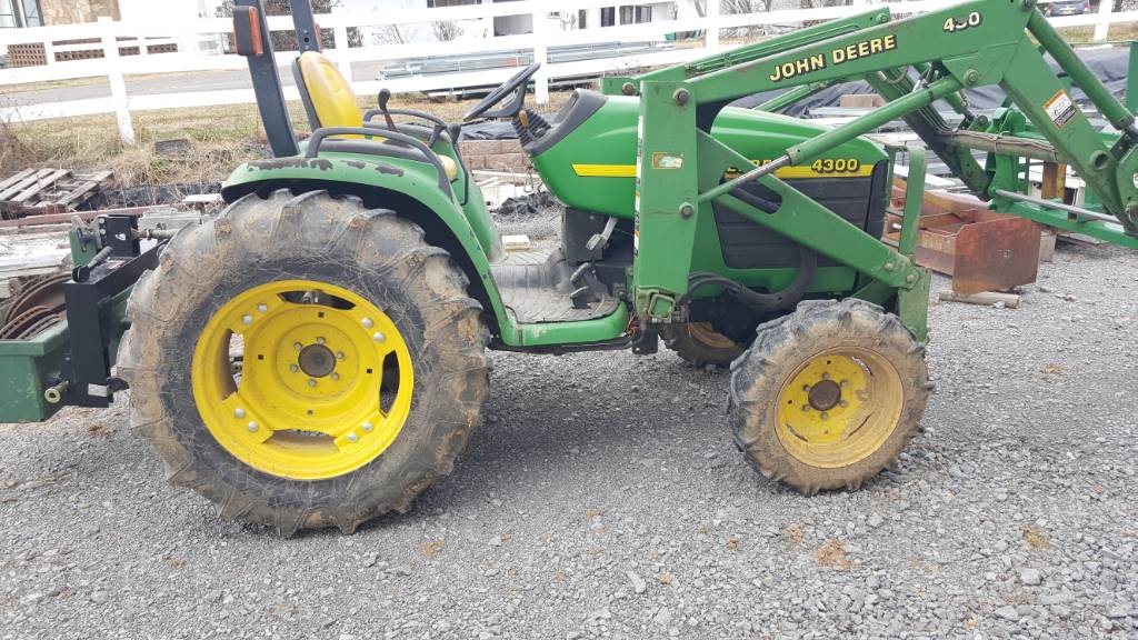

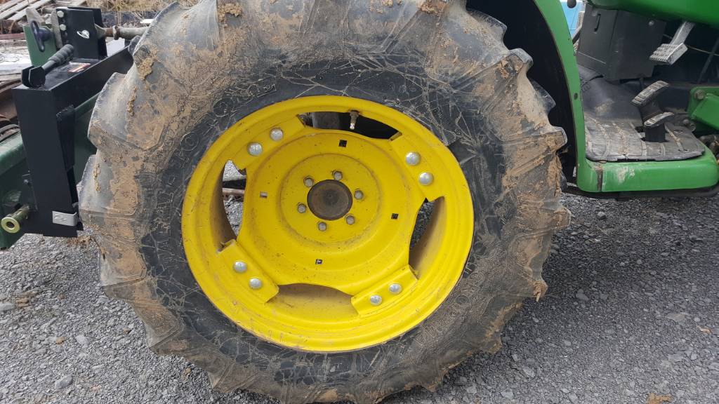

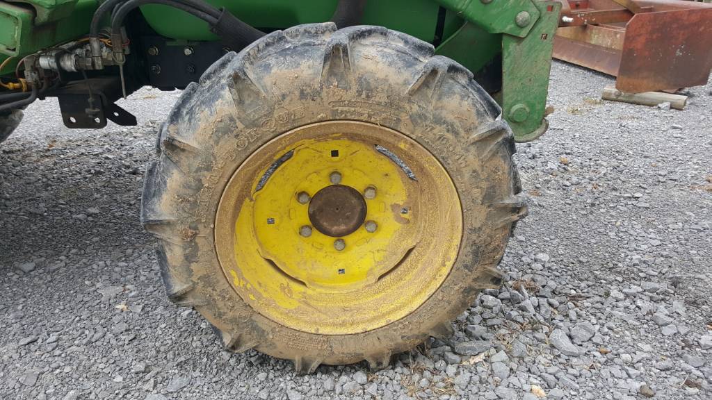

jthibodeau89
Can you share a pic of the set on your 4300 ? Would like to see how the 4300 looks, and what the rims look like as well.
Are they Deere rims that share a number of different wheel widths ?
Did you find a buyer for the original rims ? and were the old tires R4's ? Sorry for all the questions.. ;)
   / Who has really done a swap of R4s to R3 Radials (and net $)?? #5
Pics attached. I went up a size for more ballast in rears. 7-16 front, 12.4-24 rear. Rears are 2pc for adjustable width. We set them 3rd widest. I can still swap sides to get 6" or so wider per side. Rears filled with Rimguard. We have a hill farm, and took 1 too many down hill slides on the R4's.
Still have the original 7-15 and 15-19.5 R4's here at farm. Tires are 30% at best. Still filled with MeOH. 20201225_120850.jpg20201225_120926.jpg20201225_120944.jpg
