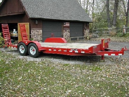

Latest trailer is a hydraulic tilt, H&H, 10,000 GVW, 20' wood bed, radial tires, dealer delivered. I love it. Very safe and quick loading. I use Sikkens deck stain to protect the treated wood from turning gray.

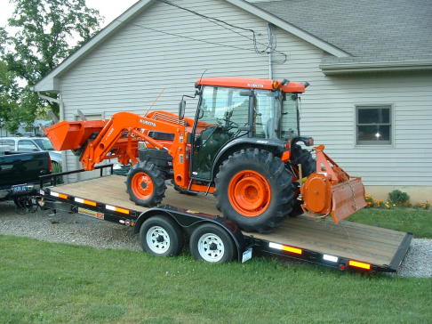

20' MacLander I picked up at the dealer. Wood deck with a 2' foot steel beavertail. 2 7K Dexter axles with 4 wheel brakes and DOT lighting and reflective tape. Came with 2 5/8" Drings on front, welded 2 more on rear crossmember.
It might be derated since it's a 12K trailer with 14K worth of axles. Tires are 235/16 Radial, load range E. Have had the rest, like this one the best. /forums/images/graemlins/grin.gif
