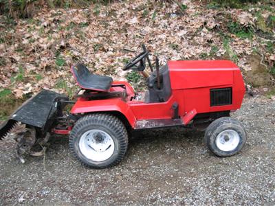

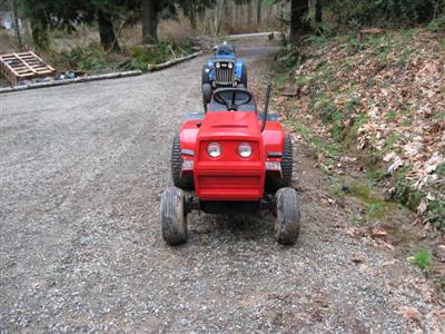

here my 1977 mta 918 w/tiller yes it work great mows great to

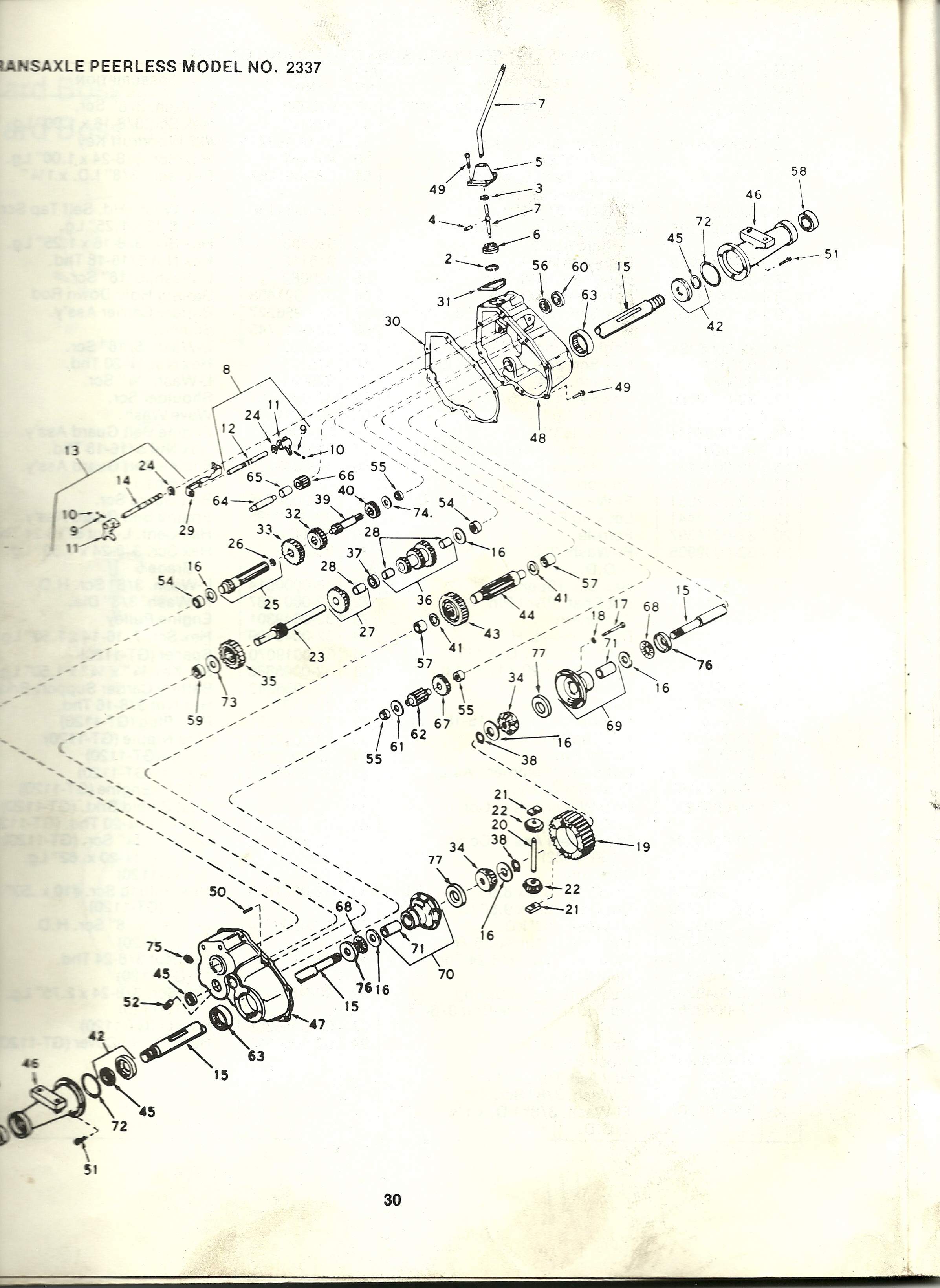

   / White GT1622 - Same as MTD 918?
I still have it.... but it doesn't do much anymore. The transmission blew on me after this hellacious winter of plowing (record all time seasonal snowfall here in southeast Michigan). I probably was too impatient and fairly often would shift between 3rd and reverse without coming to a complete stop (some grinding of gears). Then again, 2nd gear never did anything, so there could have been some pre-existing issues.
The shifter went totally limp/loose and it seems to be stuck in 1st gear, but now it's jammed and just smokes the belt if you let the clutch out. Having a big heavy garden tractor that can't be a rolled around is a big pain in the ***...
Transaxle replacement a feasible job on these beasts?
   / White GT1622 - Same as MTD 918? #8
The transmission isn't totally shot. Chances are it's just a little $.50 spring that holds a ball in place in the shifter fork on one of the shafts in the transmission. The spring probaby collapsed which then allows the shifter fork to slide out of position and lock up the transmission. a temporary fix is to take out the shifter(3 bolts) then reach in with a screwdriver and slide the shifter fork back to the centre and reinsert the shifter. It may take a little rocking of the tractor to free the fork, but it should come free. I have attached an exploded view of the transaxle. The slipping problem can be cured by tightening or looseninf the nut on the shaft that goes from the variable speed shifter(on the right side of the tractor above the pto lever), its located under the hood, right beside the battery. I attached a picture of that as well.
