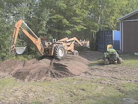

Sounds like he wants a faster lawnmower & TLB.
I had 30 yards of class 5 gravel dropped to level out in front of barn. My lawnmower with a 72" rake would have taken all day to drag it out. Added a TLB & it took a total of 2 hours.
TLB is old 60 hp but same concept.
