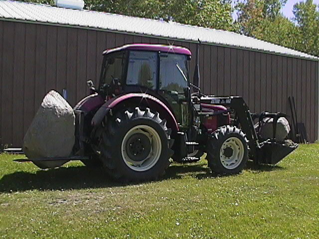

Clearing land is tough on machinery & your new tractor will be looking old real quick. Have you considered a much larger 100-150HP old used tractor JD4020 IH 1066 etc? Once the land is cleared or close to done sell the beast & then buy new & maintain.
Separately consider construction type equipment: an industrial TLB and or a dozer both have their niche and can be indespensible! An ag tractor can dig & push but not nearly as efficient.
My new utility tractor is a Zetor. For me it was the most value per dollar & excellent long term dealer. As others stated regardless of brand buy from a dealer you are confident will be in business.
