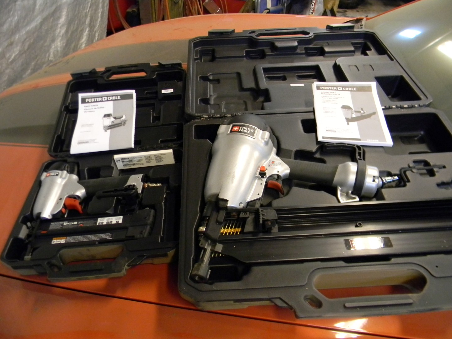

I have 2 Porter Cable air nailers bought from HD. I have the small nailer that does brads and nails from 5/8" to 2". The framing nailer does 2" to 3 1/2" nails. I have 2 small compressors for field use or can use the large garage compressor for work around the house. Never had a problem with either one. I thought of buying the battery powered ones but price was quite a bit more than the air units. Didn't look at gas powered. I'm not a contractor so I don't use them every day (as can be seen by the dust on the cases) just for general projects around the house.
