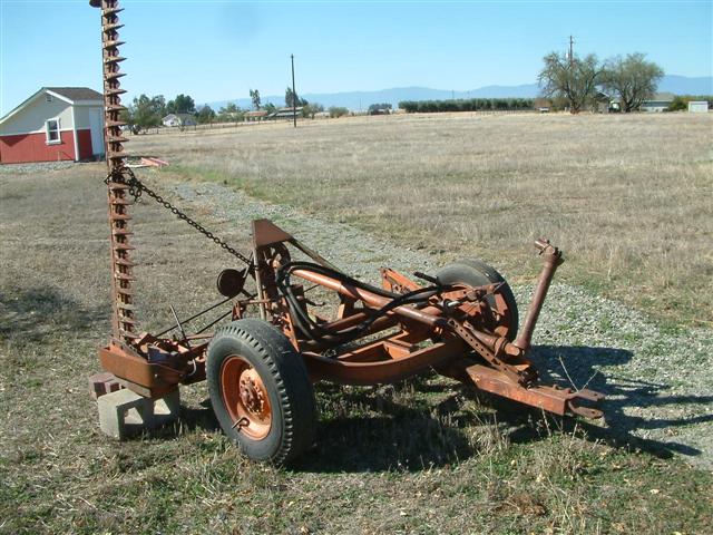

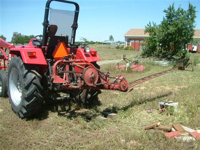

What's your mower budget? I have 6 of my 10 acres going into oat hay this Fall. My mowers are a used Massey Ferguson MF41 sicklebar (7ft, $550 at auction plus about $125 for new sickle sections and guards/ledger plates)
and a used Allis Chalmers 80T tow-type sicklebar (7-ft, $150 from a neighbor).
Either one of these mowers could handle your 15 acre hayfield with ease, but it might take longer than you like to do the mowing job. And sicklebars have been know to clog up and require you to back up to clear the mess.

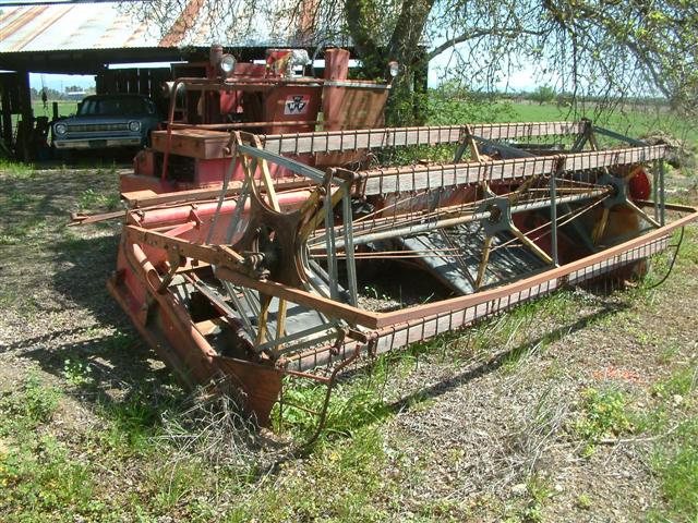

Or, going the whole ten yards, maybe you would like to check out self-propelled windrowers. You can find these used for $2-10K depending on type of head, size and vintage. My neighbor gave me this old Massey Ferguson 44 windrower--a future winter restoration project. It has a 12-ft wide draper head with a sicklebar mower. I'm going to have a ball getting this old hunk of iron working again.
