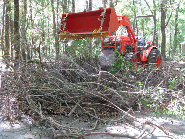

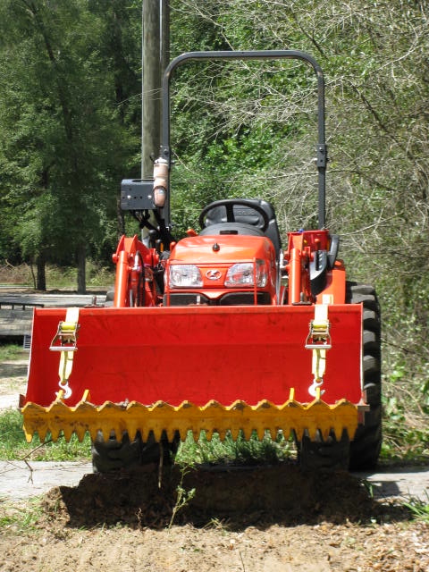

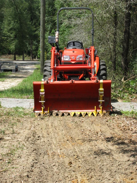

~~For leveling your FEL bucket should mostly suffice, with the tractor operating in reverse. For anything but soft dirt add a Ratchet Rake to the bucket. Ratchet Rake is excellent for landscaping and light grading. Ratchet Rakes are sold by the T-B-N store.
VIDEO: https://www.youtube.com/results?search_query=Ratchet+Rake+grading

Thanks for the advice. I haven't seen the Ratchet Rake before, That is an awesome tool.

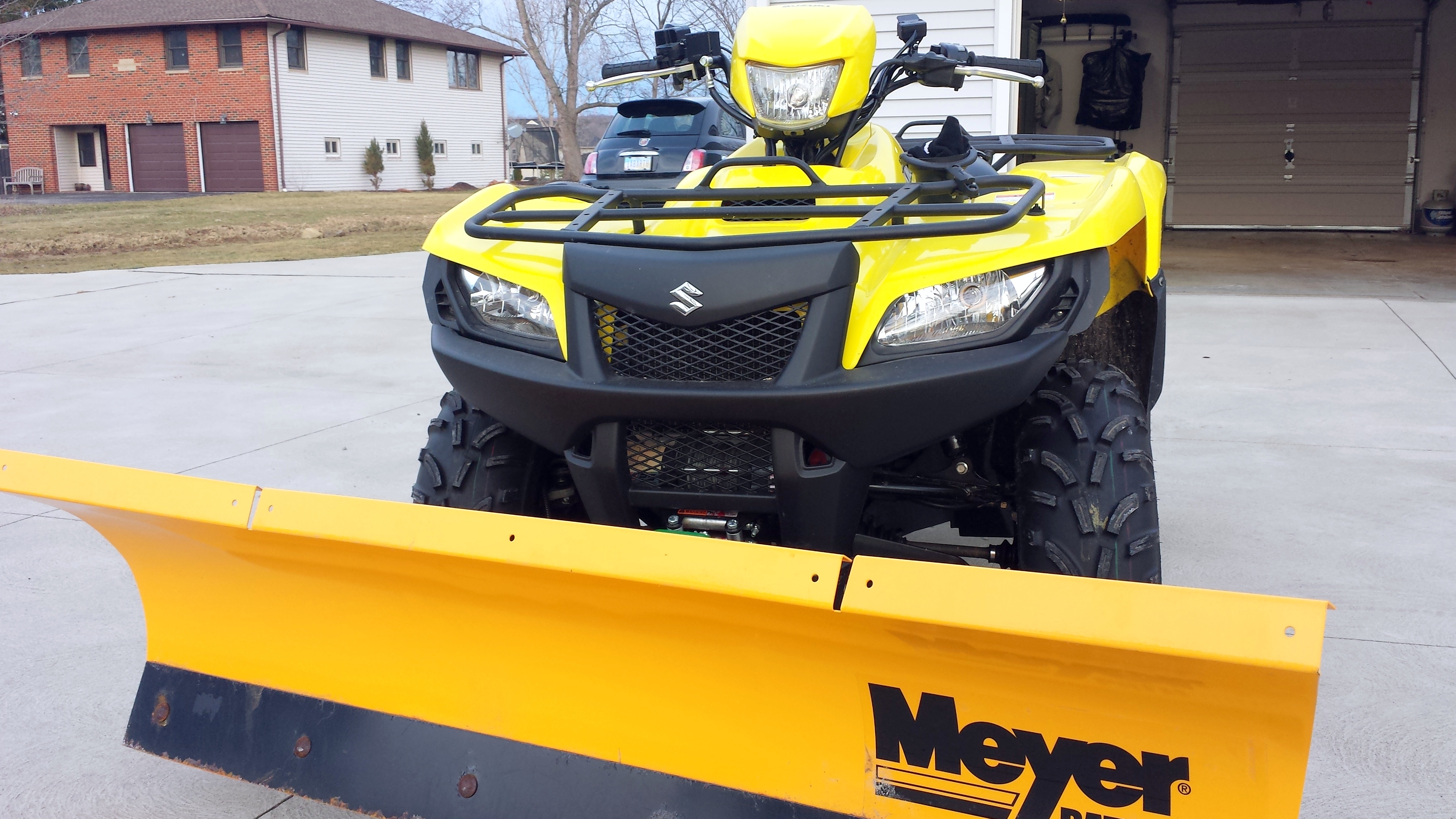

I use Suzuki King Quad 750 and 60" wide Meyer Path Pro plow. It does good job plowing snow on concrete.
