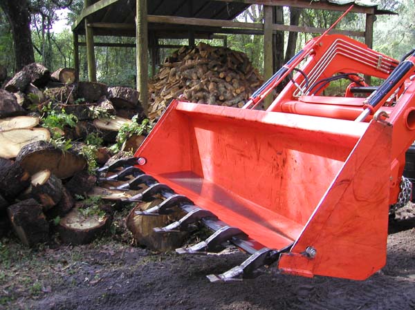

We got our toothbar for our L-3130 with LA723 FEL from Carvers, it is a WR LONG.
I did manage to break off one of the teeth shanks while pushing on a live oak stump.....

SkyPup,
In your picture it looks like the toothbar is sticking out to far, not butted up against the bucket egde.
Is it just my imagination ?

I enlarged the pic, and looks like it needs to slide back into the bucket about 2", all the way back to the bucket cutting edge, lucky it didn't bend it all out of shape, good eye you got there.

He did mention that he broke a tooth shank. My quess is that is the reason why. The shanks are not up against and supported by the bucket edge .

Hopefully skypup will comment on this. A broken tooth on a properly mounted bar doesn't make the manufacturer look too good unless it was abuse. I bought one of their root grapples and they seem conscientious.
