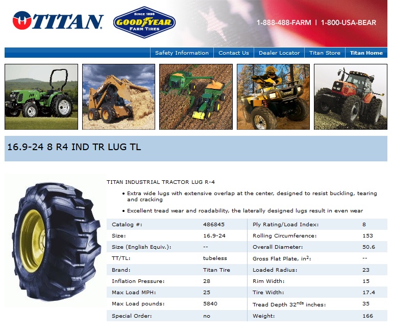

I agree, counter intuitive, but here are both tires directly from the Titan catalog. Both are Titan Industrial R-4 8 ply tires:
16.9 shows 17.4" total width
17.5L shows 17.1" total width
Looking at the 6 ply Titan tires, it's even worse, with the 16.9 showing 17.9" tire width, while the 17.5L shows 17.1" tire width!
It appears the higher ply Goodyear tires, with a more R1 style tread, do fit better with the nominal sizes. The 6 or 8 ply Titan tires with standard R4 tread all seem to be opposite what the sizing would lead you to believe.

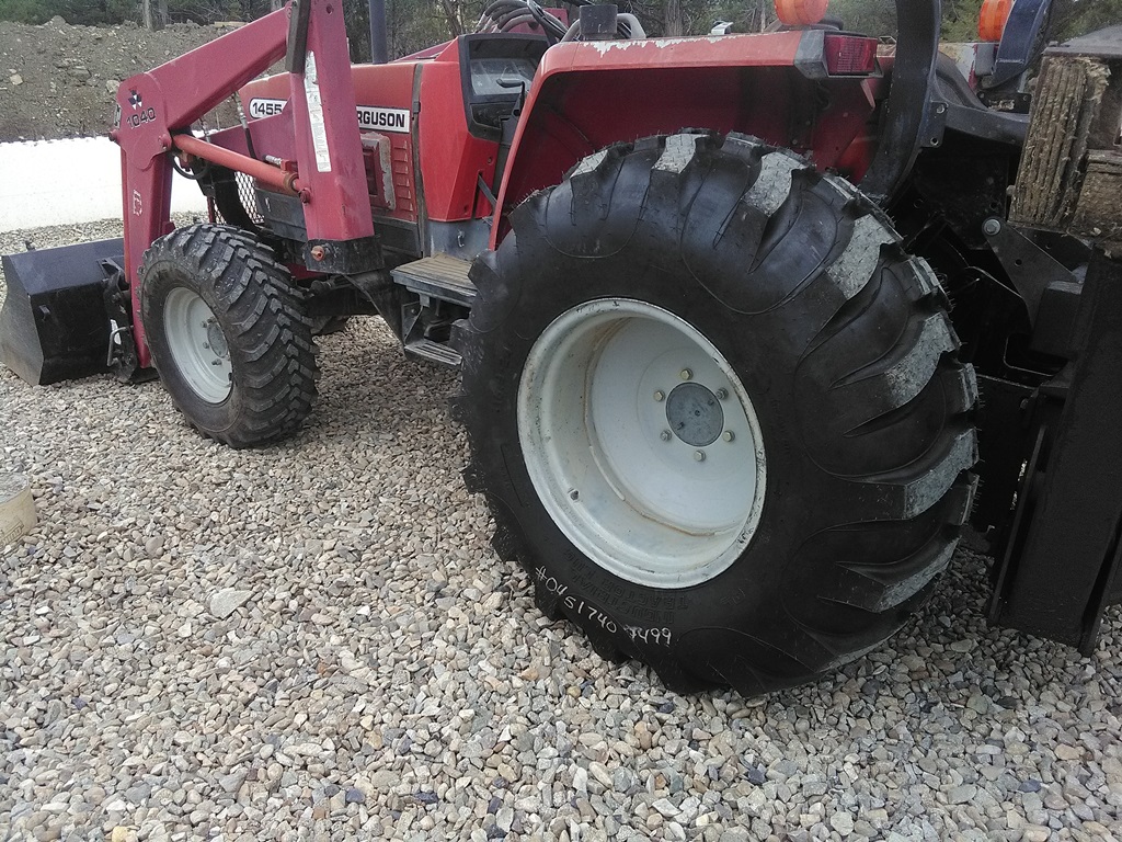

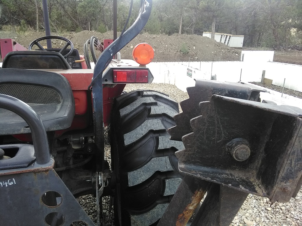

Ok, so my 16.9's are finally installed. As mentioned above, the installed width (measured to the widest point, which is the sidewall) is very similar between the 16.9 and the 17.5L. I don't have calipers big enough, but both tires hide the rim by roughly 1/2" when viewed from the back.
The big difference is that the actual tread of the 16.9 is noticeable narrower than the 17.5", not just the .6" you might guess by the size designation.
Also interesting is that the 17.5L's have a fairly flat tread profile, while the 16.9's have a more rounded profile. I haven't had them on long enough to figure out what the pro's/cons are in my case. At this point, I don't really see a difference, aside from perhaps a little less thump-a-thump from the lugs as I run down the road. (I'm running the same pressure as I ran in the 17.5L's)
You can see by these two pics that the tread starts inboard of the sidewall bulge by ~3/4" or more. The 17.5L's tread was more parallel with the widest point of the sidewall when installed.
Not as obvious in pics, but to the eye, the tread is very rounded.
17.5L's for comparison. They are un-mounted in this pic, but didn't round out any more than this when mounted/inflated.
