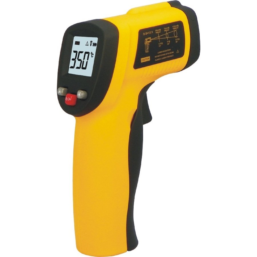

Buy a simple infrared gun and take measurements on the head. You do want the oil temperature up high enough to boil off any moisture.
