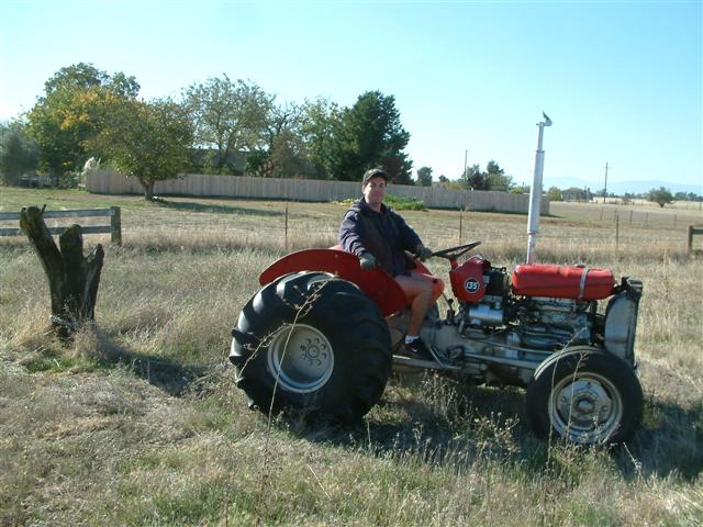

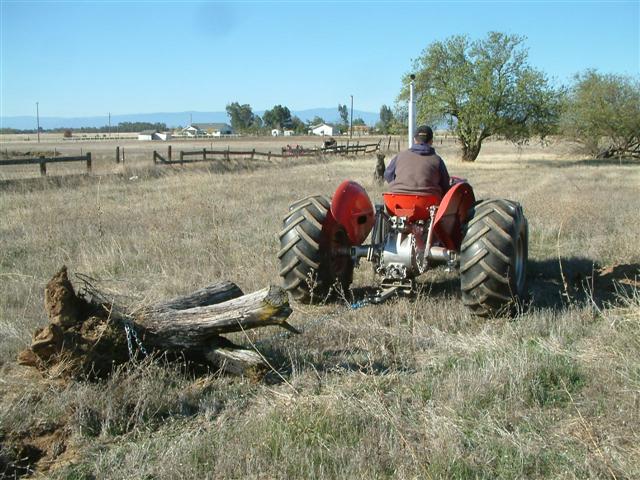

Light weight---or, another option, high flotation, low wheel loading.
For example, my 1964 MF135 diesel is fairly heavy (4500 lb or so with loaded rear wheels), but the guy who sold it to me modified it for use in his olive orchard (discing, mowing with brush hog or flail mower) by using 16" dia rear wheels carrying BF Goodrich 6 ply 18.4-16A rubber. He wanted to avoid tire ruts among the trees while lowering the tractor as much as possible to avoid getting a facefull of low hanging branches. These tires are typically used on combines and swathers and are readily available at most tire stores in farm country. He replaced the usual front axle spindles with shortened versions to keep the tractor level. With the lowered CG, that 135 is a nice setup for mowing steep slopes.
I suppose you could use wider front tires to increased flotation.
Just passing along an idea that might be of use to you.. BTW: I paid $3600 for that 135 in Jul06. Tractors like this show up all the time on eBay and craigslist. The modifications shown here are easy to make.
Good luck.

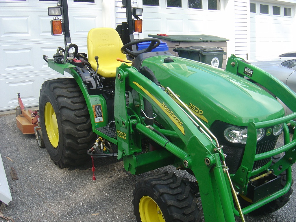

Hiya,
How about a really nice used Deere 2520? And as luck would have it, I have one that needs a good home.
I also have a good 3pt 5' finish mower that can go with it as well.
I'll give you a fellowTBN'er deal.
I'm in NH, almost right down the road.
Tom
