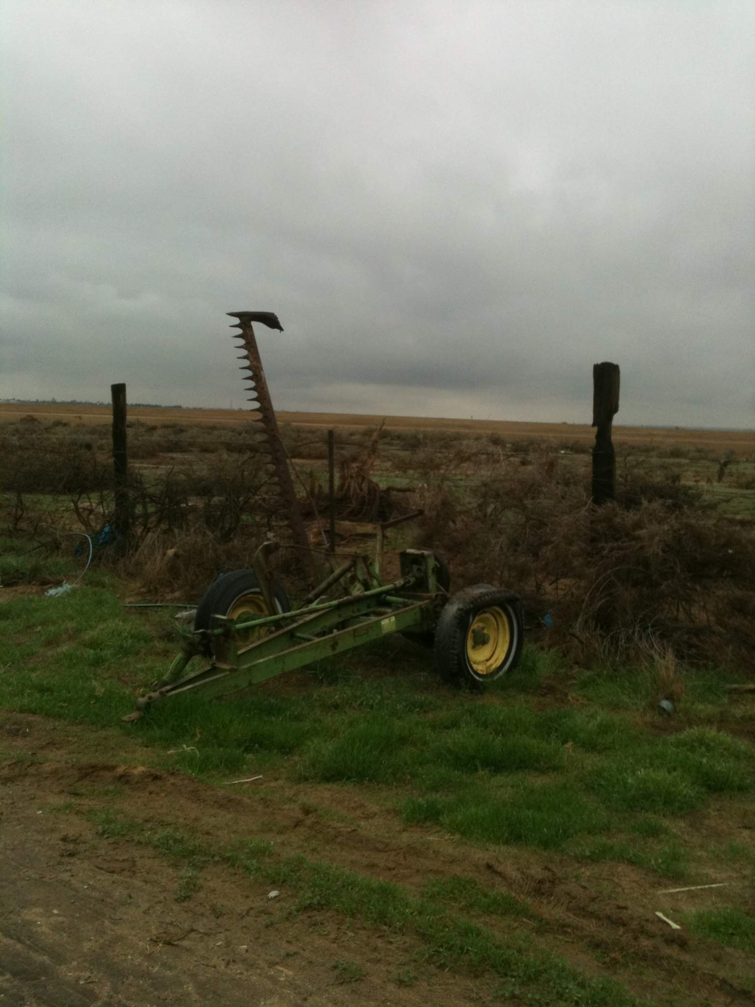

one is a jd tow type pitman arm one the other is a mf belt drive model 41 ??? any thoughts on which one i should get?? could not get the mf pic to work

I'd be more inclined to go with the belt driven model. Pitman arms like to break.

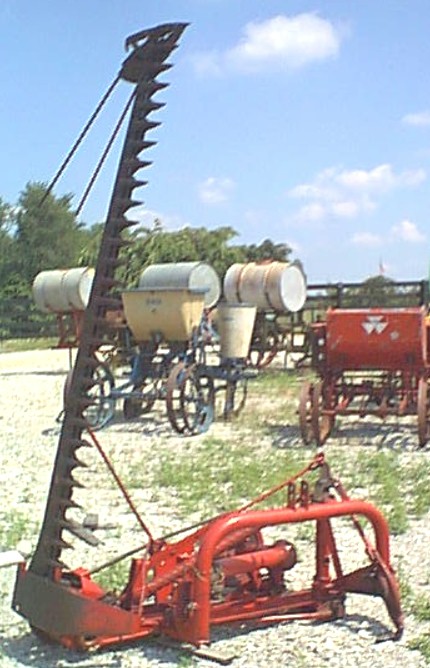

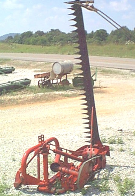

The 41 will give you more flexibility in the angles you can mow. 70 degrees below horizontal and 90 degrees vertical. Pull type usually require hydraulic remotes to raise and lower a cylinder? Picture of a Massey #41 we have in stock below. Ken Sweet

like everyvody else id go with the MF41 ive always liked the belt vs the pitman arm:thumbsup:

I have an MF31 belt driven sicklebar so I'd go with the 41.
Don't know the condition of that 41 you're looking at. The sicklebar on mine needed a complete rebuild (new sickle sections, new guards) and the 7-ft long steel bar that carries the sections was bent and had to be replaced. Couldn't find one already made so I had to get some steel bar stock and drill about 60 holes in it for the sections (4 sections per foot) and for the attachment to the drive unit. Also be sure to check the outboard shoe and the end of the sicklebar to be sure that the fit is correct there and the sicklebar slides properly. It helps to get the operator, parts and service manuals also.
