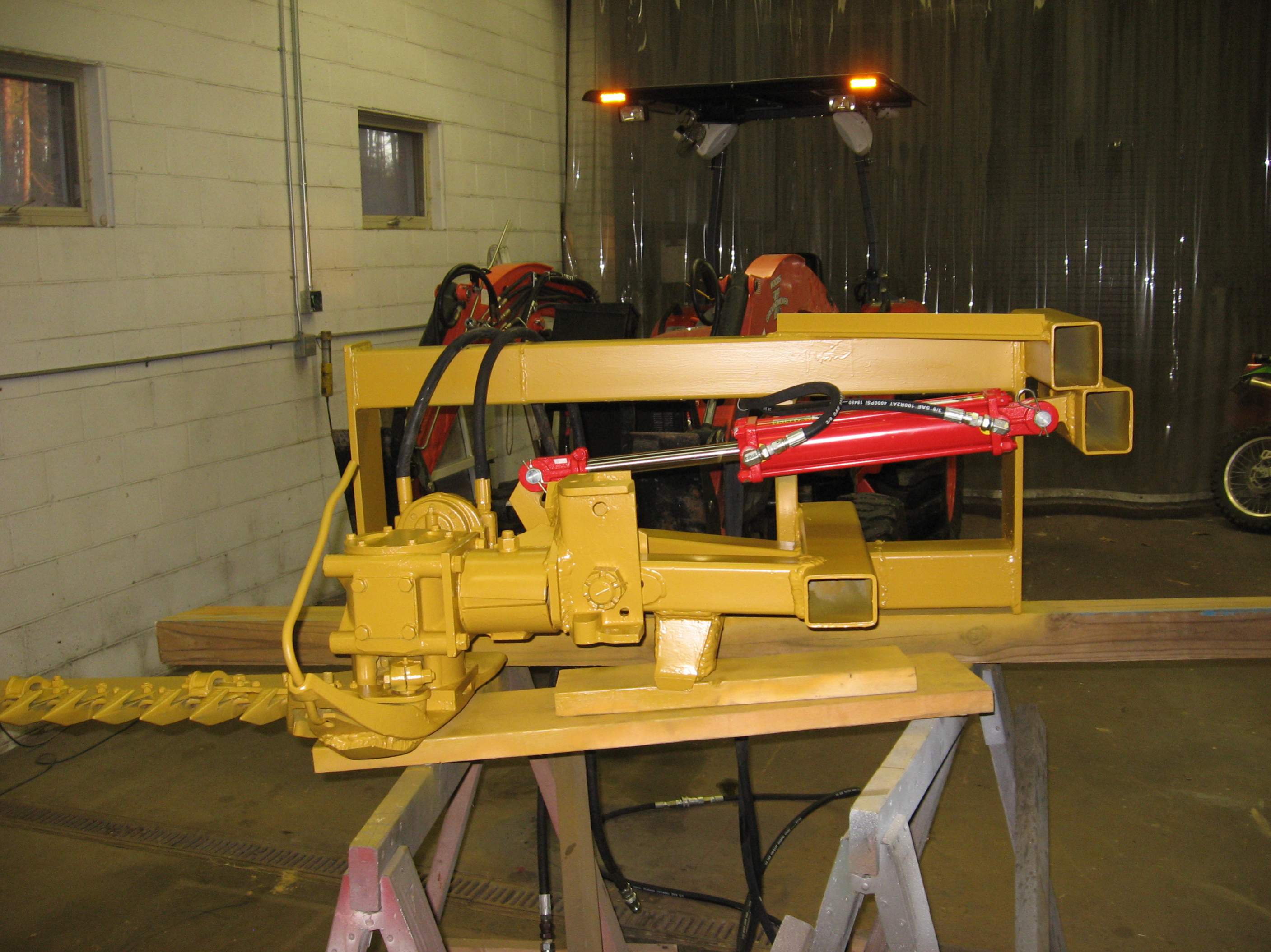

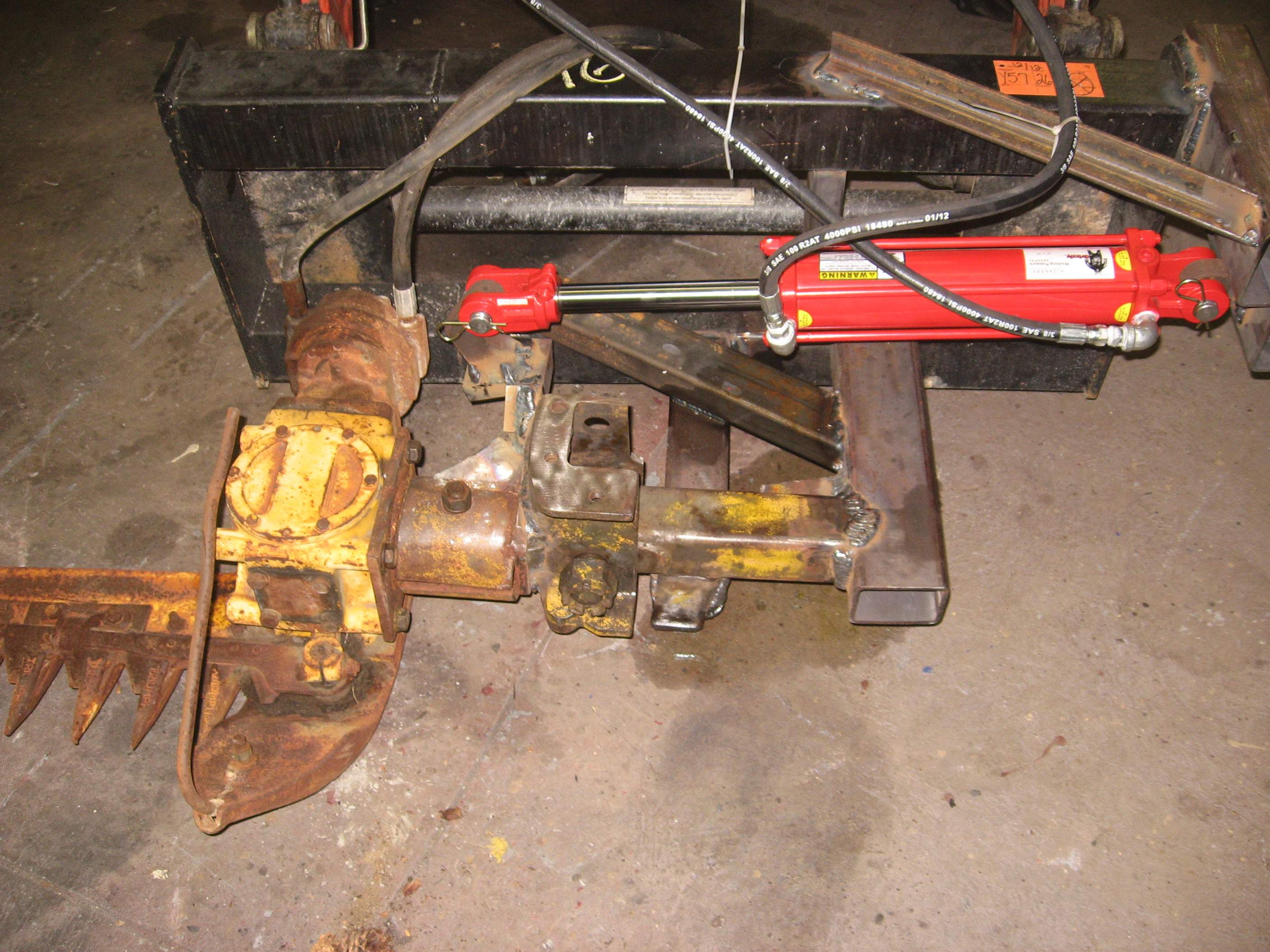

Not sure if you want 3 point but if you can find a Triumph/Alamo hydraulic sickle mower you can do anything with it. They will cut a 2 inch oak limb if handled the right way. 2 inch pine is pretty easy. You can find them at auctions or ebay with some looking and time.
I made this one 2 years ago just on a idea. After using it for 2 years pond and **** mowing plus trimming trees up to 20 foot it has quickly become my most valuable attachment.
New blades are cheap and easily available at Agri-supply. If buying any sickle mower I would replace all blades. Bolt on is the way to go. Also hold downs or retainers.
I have a video of it in action on my phone but cant download says file is to large. Making one is a lot of work but this thing is bad ***.
These are pictures of when I made it best that I have.
