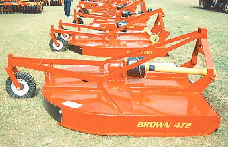

There are many good choices. I'll throw in a plug for the Brown 472, which I've owned for years. It weighs around 1200 and is basically identical to a Bush Hog 286, but possibly a few dollars less depending on your dealer. There are many threads on TBN about picking a rotary cutter for tractors about the size of your M5040. The major manufacturers all make a 6 ft model in the 1200 pound class. Need to compare apples to apples - a 700 pounder isn't going to hold up grinding up trees.
Brown makes heavy-duty tree harvesting equipment too so they are all about beefy design. The 400 is their middle-weight series. They also offer a 600 series that's even heavier (6" blades, 1/4" skirt) - but I think you'd find the 400 series to be plenty. I've used my 472 to open long-neglected fields with 4" pines and 2" hardwoods. It's up to the job. Brown product page here
