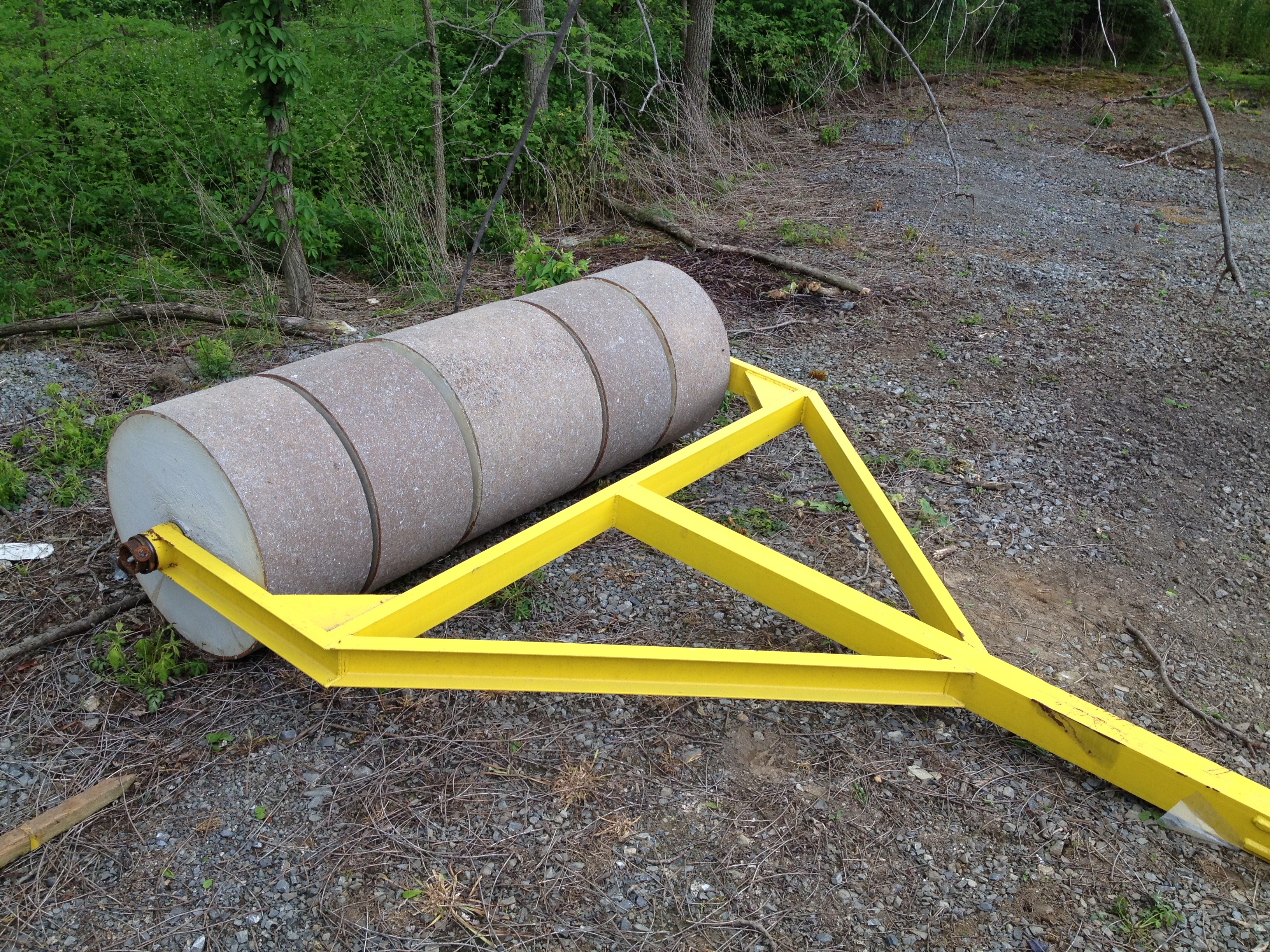

The 2 acre lawn part of my yard is full of lumps & bumps, so much so that driving my BX or my Z122 mower is like riding a bucking bronco. I thought of rotavating it level and re-planting grass but the problem of the bumps is likely to return. My other thought is to buy a roller to flatten some of the bumps when the ground is wet, so I'm asking what size & weight of roller would suit the BX2350, hopefully at least 4 feet wide. My yard is very gently sloping.

It’s not just the width but the diameter. I have a cheap plastic one and it’s a little too small. Kind of guessing as I looked at a few on line but mine is probably 36” wide by a diameter of 18”. You probably want a bigger one.
   / Which roller BX2350 #3
I would say at a minimum the roller should be at least 4 ft wide and around 900 - 1000 lbs. depending if on height of bumps and type of soil it may not help much. Heavier is better
   / Which roller BX2350 #4
Depending on the size of your lawn, you might want to look into either renting a vibrating roller or hiring a lawn equipment guy that has one to try and flatten it out for you. I doubt anything you are going to tow behind your BX will do the job. I have a 5 ft long x 18 inch diameter roller, full of water, and it flattens the grass, but doesn,t really do much to flatten the soil.
   / Which roller BX2350 #5
Get someone who CAN do it and make it their job. I went to the trouble of bringing this DIY roller from work a few years ago to do my yard. It's 6-1/2' wide and made of concrete-filled 24" diameter SCH40 steel pipe. Although it was early in the Spring (before the ground dried out) my yard laughed at it.
   / Which roller BX2350 #6
Lawn rollers are for pressing seed into tilled soil. They will do little to flatten worm mounds and bumps in an established lawn.
   / Which roller BX2350 #7
Your foot will put an imprint into wet soil that a roller can not erase.
