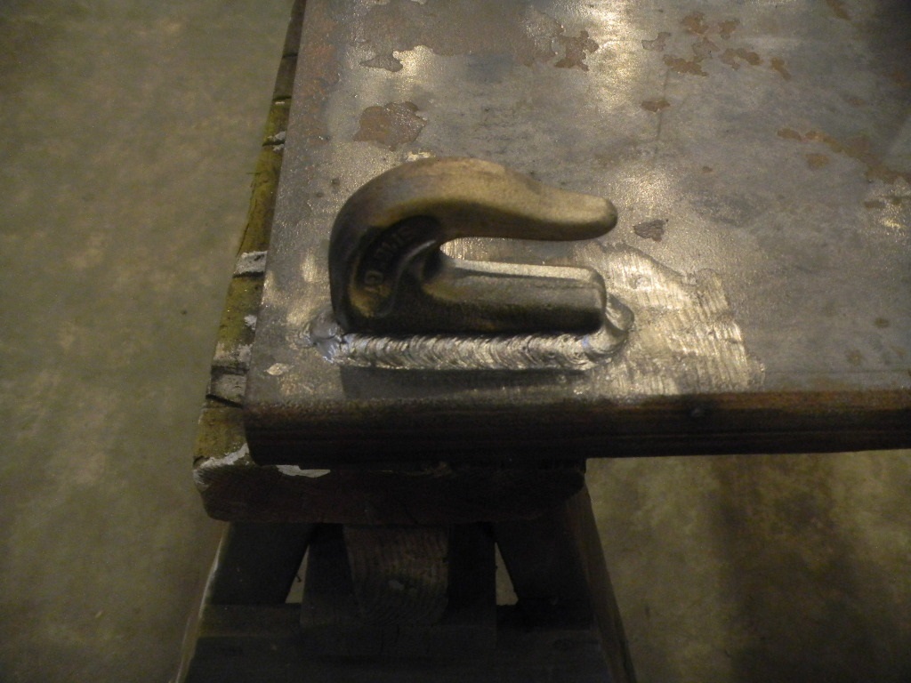

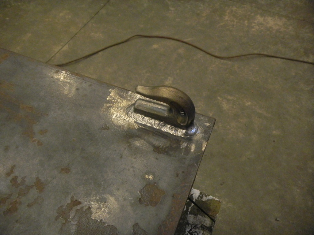

I am a novice welder. I would like to weld another 3/8" chain hook onto the front end loader of my Kubota L3710. The previous owner added a piece of angle steel onto the top edge of the bucket to serve as a base for chain hooks, and there are two hooks solidly welded onto it now. That angle steel is 1/4" thick.
I have a 240/130 AD/DC stick welder.
What rod (both number and diameter) would you recommend?
What power setting on the welder?
Thanks.
   / Which rod? What power setting? #2
I would use 1/8-inch 7018. All welders run different. Try around 110 to 120-AMPS

Shield Arc,
That's exactly what I'd like mine to look like. Thanks.

Not bad for a guy who has only been welding a few weeks.

As Shield Arc said, 7018 with 110-120 amps, but I would just add that be sure to have a bit of scrap plate available to test an practice on. Just to test the settings and your skills before you attack the final part. As he mentioned every welder is different. I just completed a large for me project with 1/4" and 3/8" steel and I did it all with 7018 1/8" and when I was practicing I found that I had to run my welder at 140 amps when I was in the flat position. If I was down near the recommended amps it would stick and sputter. I rarely use my machine for SMAW.
I don't know if I was really using 140 amps or if my dial is off, but the end result was great. Well worth the 3 or 4 practice rods and some scrap 1/4" plate.
Good Luck.
