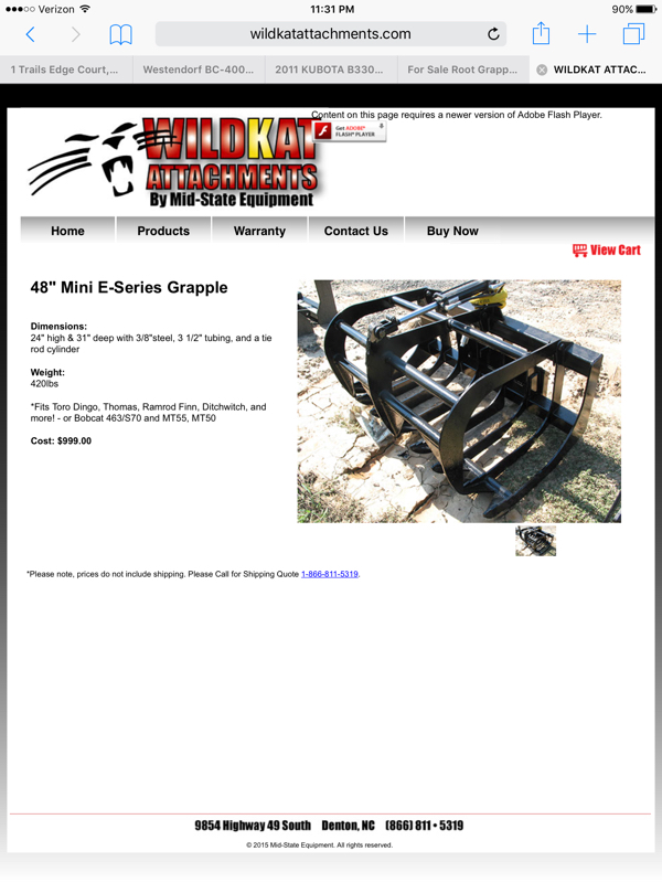

Here's one to consider
Sent from my iPad using TractorByNet

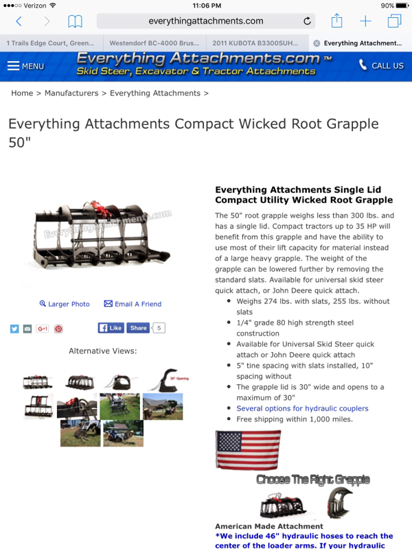

The lightest one you can find that is built to do what you want. The overbuilt monster grapples are great, but kill the FEL capacity. The EA and LandPride options at right around 280lbs are nice units. I personally got the LandPride unit with my package and it is very well built for how light it is.

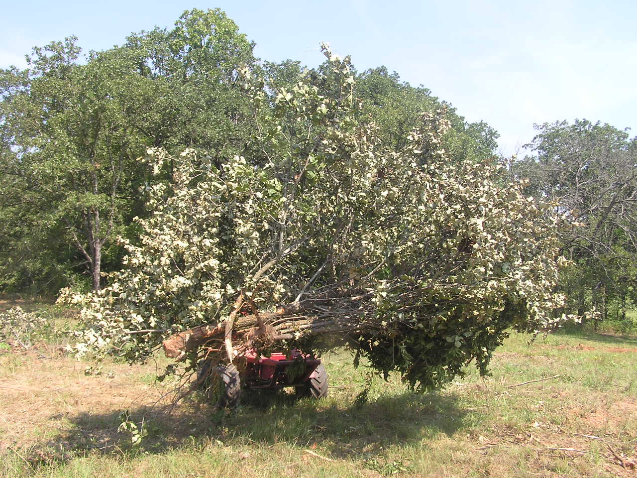

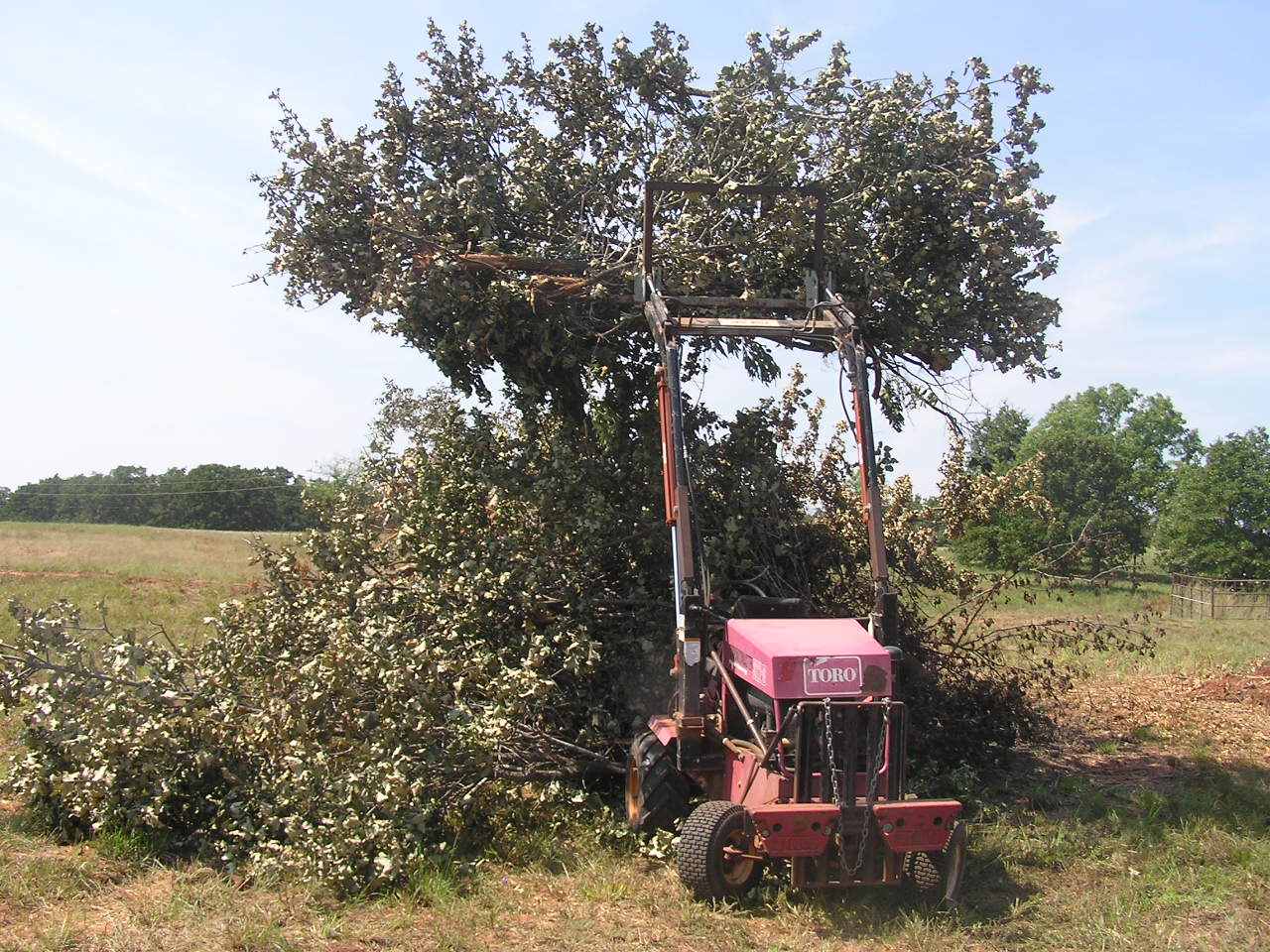

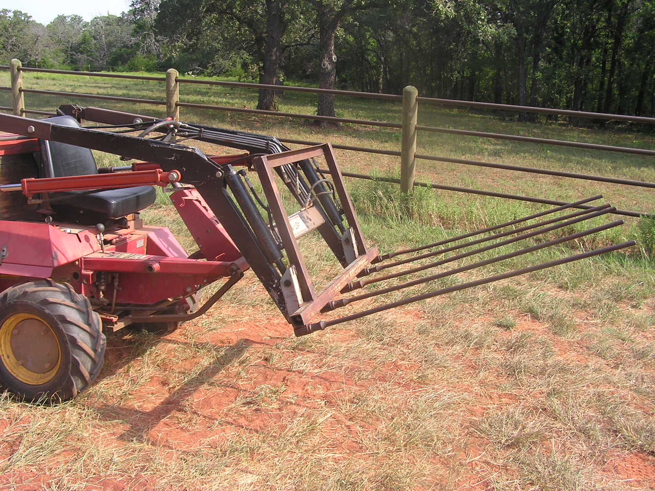

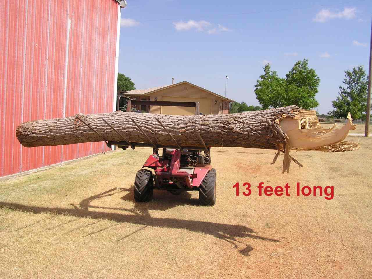

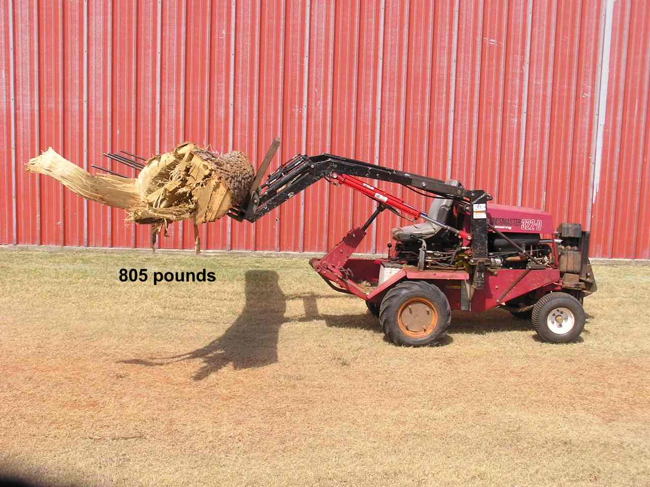

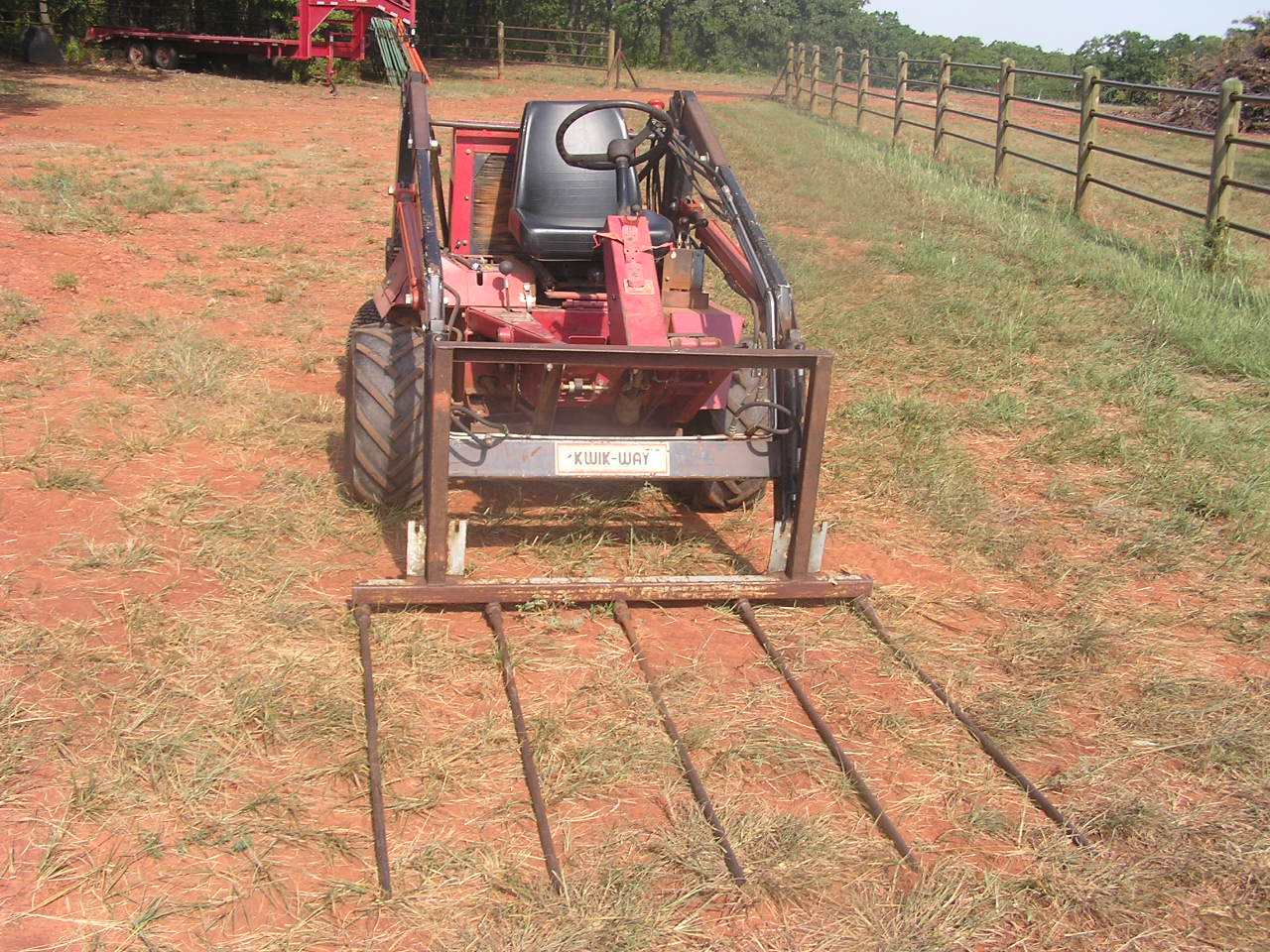

I think the Brush Crusher would be your least cost, quickest solution for moving tree tops.
This is what I made for my pin on loader: http://www.tractorbynet.com/forums/...ter-put-together-post3455827.html#post3455827
