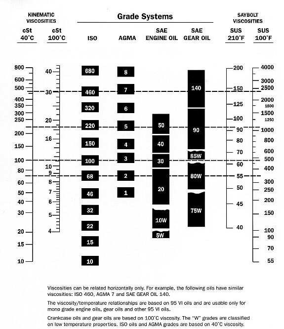

Local farm stores carry it here, I've seen it at Rural King too. Guess it just depends on your part of the country. You're right about it being in the 30-40 weight vicinity, depends upon manufacturer. This chart will give you an idea.
ISO100 is adequate for mine in the winter, but it's still too thin for summer. Since I can't find thicker hydraulic oil, my summer solution is 50W racing engine oil. We're only talking a quart and a half reservior here, so it's not that bigga deal changing between summer and winter steering fluid.
//greg//
