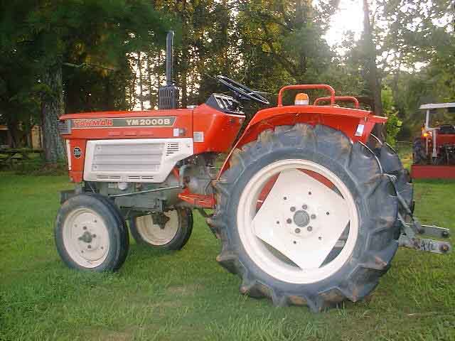

It is a "B" model of either a 1700 or 2000. It is kind of hard to tell without something to gauge the size with . I am leaning towards a YM1700BD. The side screens are missing. The "B" models have different side screens and headlight bezel and the dash board hash gauges instead of warning lights. Othe than cosmetic changes there really isn't any difference. Here is what a YM2000 "B" model looks like complete.
