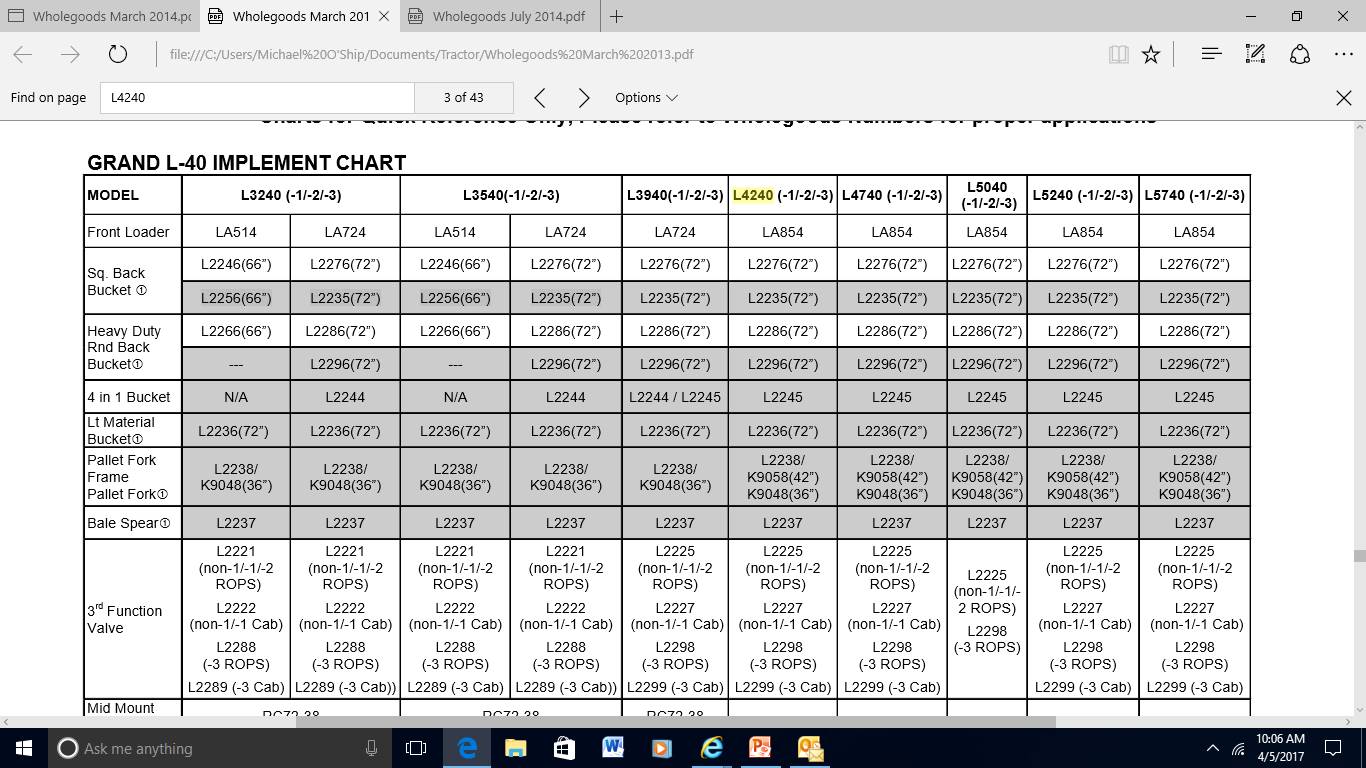

Hi all,
I bought a new L4240 Grand L-series tractor last year (with cab) and am looking to add a loader to it. What's confusing me is that the UK brochure says that the 4240 needs to have the LA714 loader NOT the LA854. The LA714 is a lot less capable loader for almost exactly the same price as the LA854. Reading other threads, it seems that everyone on this forum seems to have the LA854 with the 4240, so am confused. I thought that the frame was exactly the same on all the xx40 grand L models? Is the 4240 different? According to the specification sheet, the implement hydraulic pump on the 4240 is more powerful than on the models with more HP, so it can't be a flow issue.
Anyways, I'm waiting on a call back from the Kubota dealer (which from experience will be several days time or not at all) and in the mean time wanted to ask the brain trust here whether you know why the lower spec loader is matched to just the 4240?

The frames are different but I think the loader frames are adjustable. I also have the 854 loader on my 4240. I think you might be running into a problem because of where you live. I know Canada and the US have slightly different options (and Kubota loves to keep people in the dark when it comes to different countries). Can you check to see what the 4740 gets for a loader? I know in the US the 3940 got the smaller loader (724 I think) however I know people who got one with the 854.

When I bought my L3940, I thought the L4240 took the LA854, not the LA724 (not 714). I almost went to the 42 for the loader, kind of wish I had.
   / which loader for L4240 #6
Here's what I found in one of the Wholegoods catalogs.

My spec book says LA854 starts with L4240.
