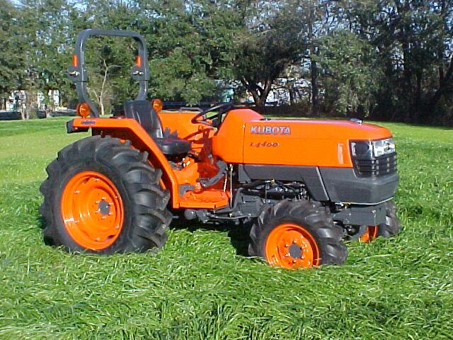

   / Which Kubota: L3400; L4400; L3830? #7
I have the L4400 and could not be happier also. I wanted the power over the GST or HST transmission too With the Hi-Lo & rev. lever on your left side it is so easy to do the tasks that I need to do. The tractor is so comfortable to opperate too, You may want to think about the rear remotes I have a hyd. top link and it is so very nice to have. It is worth evey penny to have it installed. If you have a finishing mower when it is time to clean it all you do is go in on the top link and you have real good access to the under of the mower cleaning is real easy. I pull a 6-1/2 ft. KK disk with no proplem at all, even set at the most aggressive setting. A 6 ft. med duty woods brush-bull is no strain on it too. More tractor for your buck.
